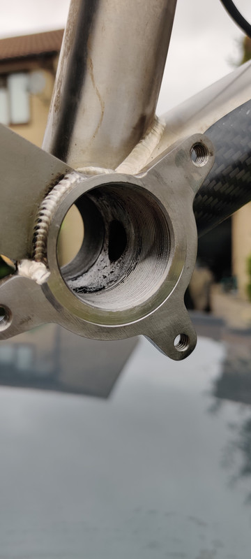

Makes me wonder if there's a market for a set of go/no go gauges for various bottom brackets. Perhaps even make them deeper and then with an accurate bore and a ground shaft, see how well a pair of them line up.
If bottom brackets are as badly made as some of these, it would be nice to know before building up a frame.

Not a fan of his approach (the zyklon B comment was uncalled for, and his fixation on MAB is cringy) but I like the engineering explanations and frame analysis.
The alignment on that BB is pretty shocking, and it should be correct. It shows a poor QA process from the manufacturer.

though saying that, he’s a classic example of survivor/selection bias with QC in the bike industry.
There is a bit to this, but it ultimately it shouldn't leave the factory, or should be rectified by the manufacturer (albeit I'm not sure they were given the chance in Kingdoms case)
The OPEN frame was an interesting example. Assuming that there isn't some lying going on with OPENS response, and regardless of how Hambini approached it, OPEN look foolish by saying 'we don't build to a standard for the BB' - i.e. we don't really care if your BB will perform correctly.
Having spoken to composites NDT specialists about assessing carbon frames in the past, I do query his NDT analysis - you need a benchmark to assess against.

Makes me wonder if there’s a market for a set of go/no go gauges for various bottom brackets. Perhaps even make them deeper and then with an accurate bore and a ground shaft, see how well a pair of them line up.
If the frame is bad enough to cause a problem, I think you would notice it during installation...

I'd like to think I'd notice during building, but clearly some people haven't. And if it's true that some manufacturers are trying to claim a wider tolerance, perhaps a shop doing a lot of custom builds might like to know before getting too far into the build.
Having said that, I've only ever owned one bike (well, two frames of the same bike) with a pressfit carbon bottom bracket and the bottom bracket was about the only part that wasn't out of spec or poorly made.

But thats half the point. It could well have left the factory “bang on”
In this case the NDS was out as well - the thread bore isn't parallel with the shell (or not faced correctly on both sides). You can't cause that through damage.
It is a sample size of 1 for Kingdom, so they need right of response (although he said he contacted them weeks ago...?) and bad BBs will float towards Hambini for obvious reasons. However, the fact that he seems to have any sort business in selling BBs to repair the symptoms of this sort of problem indicates that poor QA is an issue in the bike industry.
If I buy a frame that has an X BB, I should be able to buy an X BB and it will fit as designed. If it doesn't (and presuming the BB isn't at fault) then the frame is defective and the manufacturer should repair, replace or refund.

I’d like to think I’d notice during building, but clearly some people haven’t. And if it’s true that some manufacturers are trying to claim a wider tolerance, perhaps a shop doing a lot of custom builds might like to know before getting too far into the build.
To be fair thats true. I think a shop should have to think about something like this otherwise it's harder to identify faults. Misalignment isn't very easy to do though.
If a product requires home QA it identifies a serious issue across the industry.

I have a kingdom vendetta - the mtb frame in the original video. Its a brilliant frame, except that it eats bottom brackets. Since it's my winter bike in the main, I thought little of this, but Hambini's comments had me thinking I ought to at least check the BB facing on mine.
I eventually got around to it last week after being on the FS all summer.
This is the result of BB facing the drive side.
Vendetta BB facing

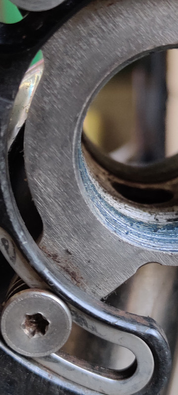

The lip you can see is the outside edge of the facing tool. The drive side BB was out approaching 0.5mm. I've had to chase the BB shell down to 72.5mm to get it lush around the diameter.
This is the same BB prior to facing.
BB facing?
It's close up so the finish can be seen, because it looks like its been ground back flush. It's a totally different surface finish to the facing tool. Interestingly, the NDS side didn't need facing in the slightest.
I think the act of welding on the ISCG plate distorts the end of the pre-faced BB tube and then its re-finished. In my case, and possibly in the now unavailable video, its not been re-finished adequately.
I suppose the moral of my story is that you should still get these things checked out instead of assuming.
