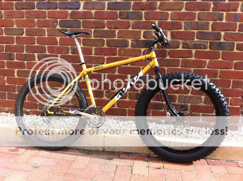

Since getting an Intense Tracer I've had a BFe frame sitting neglected in a box. I don't want to build it back up as I had it previously, bit of a long travel hardtail type bike as I have the Tracer for that sort of stuff now. I'm considering turning it into a half fat with an upside down short travel fork on the front of it too. If it's a bit different to my full sus then I'm more likely to ride it.
I'd to know what opinions people have on what this would be like to ride!

If you're going fat, IMO don't bother with suspension up front anyway. You'd need to find either an old Marzocchi Shiver SC or probably a Maverick SC32 anyway (which means they'll be old, and probably past their best), and with a BIG tyre up front you don't really need suspension anyway. Besides, a rigid will hone your skills some more!

Remember that a fat 26" tyre is about the same diameter as a 29" tyre. Add in some suspension travel and you are going to have to check your head tube angle to make sure it's not too slack to be ridable.

I think that you guys are right, I'll try it with a rigid fork first and see how I get on. There's something about a fat that just appeals!
