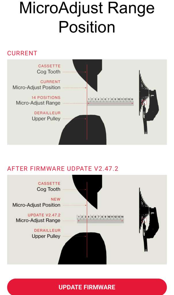

Posts: 178
Sram have announced a firmware update allowing additional inboard micro adjustment. This looks like it might resolve my gear 3 issue:
IMG_4075
Posted : 27/03/2024 4:03 pm
