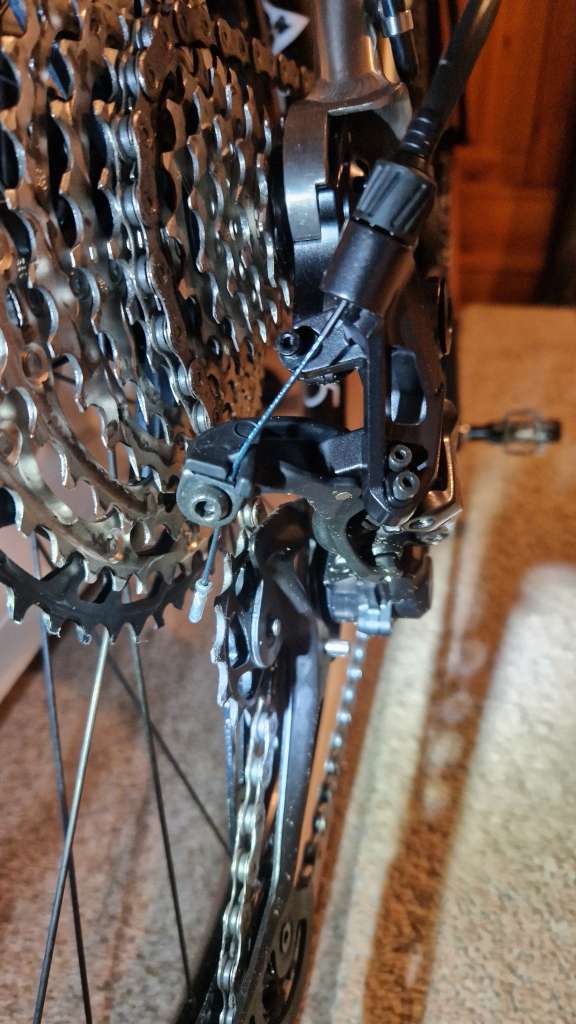

Just got a new gravel bike - it has GRX 1x12 with the 10-51 cassette. Compared to my previous bike with GRX 1x11 11-42 the lever action to shift down gets quite heavy and wooly feeling as you go up the cassette. Perfectly usable but I'm wondering if anyone with 1x12 has any experience.
Cable is Fibrax, internally routed and exits the chainstay very close to the derailleur so the loop is very short and quite acute.
Bike is Sonder Camino Ti. Really like the bike but curious about this.

Could put an old Avid Rollamajig on ther to help eith the tight cable bend.

Is it a full cable run or separate section? It looks like I can see a ferrule at either end, so a short bit. If so, according to the shimano technical documentation this length shouldn’t be fibrax, but instead the really flexible coiled outer shimano ot-rs900 - see “notice” on this page to see the length you need to cut it https://bike.shimano.com/en-EU/product/service-upgradeparts/shimano/WO-Y8ZG98090.html
It’s not “required”, but it makes a noticeable difference ime

Undo the cable and hold the inner in your hand and go up and down the gears. It should be smooth with ways if there's resistance it will mean the cable is being affected somewhere between the shifter and the mech. Maybe a kink so where or the cable being pinched by something. Also check cable route out of the shifter is following the proper guides

I thought Rollamajig for that. Perfect application.

Just looked at the picture and I think I'd want the outer cable at least 10cm longer too

The effort required/woolly feeling goes up as you move to bigger cogs. I'll drop the chain and see if that's still the case, and then undo the inner as suggested. Think I'll probably just swop cable to the Dura Ace one as well. Slightly annoying to have to faff with a new bike, but not the end of the world.

Is it clamped properly at the rear derailleur . Sometimes putting the cable one side instead of the other at the clamping point can make a huge difference to cable pull as the forces increase.

I agree with rocketdog, it looks to me that the outer is a bit on the short side.

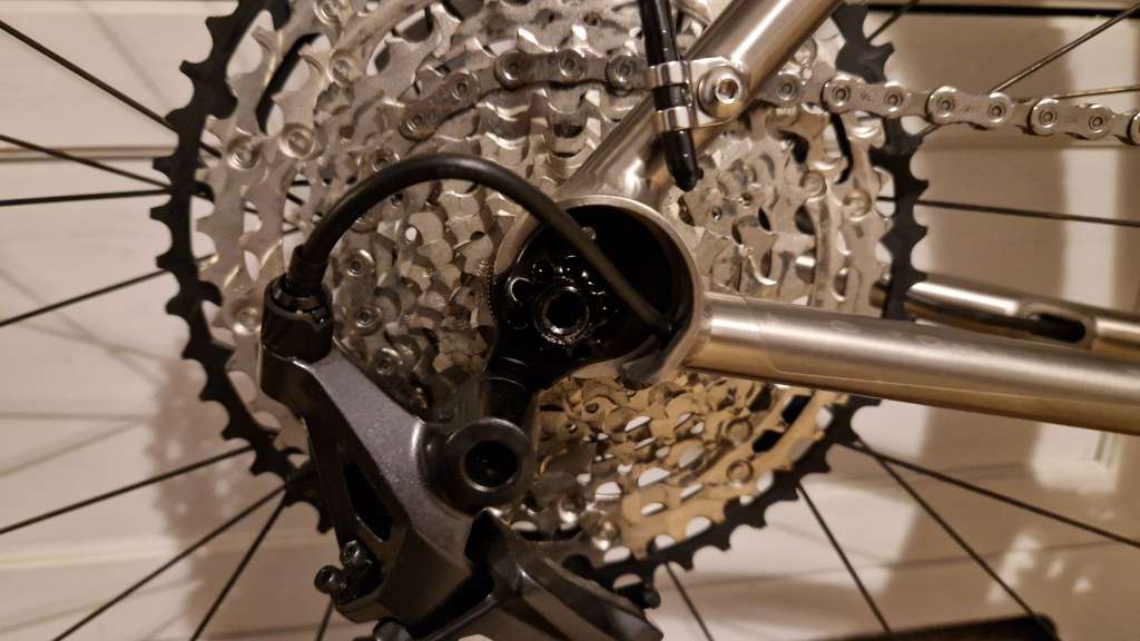

BTW I checked cable movement as suggested and its not particularly stiff or sticky. Shifts upwards pretty snappily so maybe the spring tension on the longer cage GRX mech is just greater due to the wider shift range. I'll fit the Dura Ace cable with a bigger loop and see what that does. Maybe it's just the tradeoff of a very wide range cassette. Problem isn't hideous, just a bit harder and less clicky than 11sp 11-42.

“with a bigger loop”. I’m a big fan of following the shimano technical manual I linked for guidance on that. Things have changed since the 10 speed and big loops days. That said, no harm in trying it longer and cutting it down if you still have issues.
