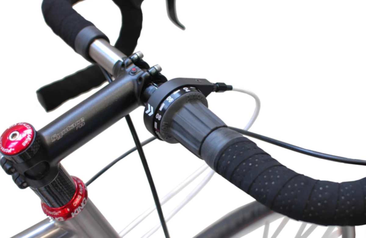

So I have a bit of a franken monster bike plan hatching in the shed of many random parts. I quite fancy the idea of putting gripshifts on drop bars, i've seem pictures on the web but they show the shifters on the end of the drops. I want to slide them up to the flat top section near the stem. The problem is I don't have any to try it and see if they will go round the bends, and I don't really want to order some to find out they wont!
Has anyone tried this?

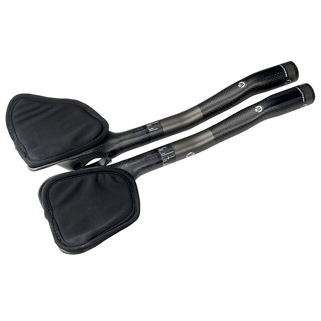

Posts: 13771
Pop a set of these on, and add left and right gripshift to them.

Posts: 2360
You have no chance of getting grip shifts past the bends. They are of necessity a tight fit and will be at least 60mm long so you'd need an ID on the shifter of abut double what is there.
Either put them on the ends, or as above a set of tri bars.

Posted : 18/11/2021 12:21 pm
Not sure you'd get them on at all, never mind round the corners, the straight bit of drop handlebars are a larger dia. than flat bars.

Posts: 4818
If you cut the bars in the middle you’ll be able to get the gripshift onto the flat part of the bar
Bin dun! Well, not quite but Van Nicholas do a drop bar that breaks down into 3 parts; it's designed for Rohloff shifters though.
https://www.sjscycles.co.uk/handlebars/400-van-nicholas-rohloff-drop-bars-318mm-clamp-black/

Posts: 513
I wouldn't dismiss the idea of having them on the ends of the drops. It looks like it shouldn't be, but is actually quite ergonomic. I prefer the arrangement to modern ergo shifters. They're also less prone to damage (or injuring your knees!) than bar-end levers.
Having said that, I'm old enough to have grown up with down-tube friction shifters, so reaching down to change gear feels quite natural and familiar.
As above, you do need to be aware of the bar diameter whatever approach you take. When I did it, I used a stub of cheap (and therefore thick-walled) flat bar filed/turned down to be a press fit in the end of the drop bar. A self-tapping screw under the bar tape made sure that it didn't move.

Posts: 3284
I'm getting a vibe that it won't work! Although I do have a few sets of older drops that are a constant diameter or with short increase of diameter around the stem area
