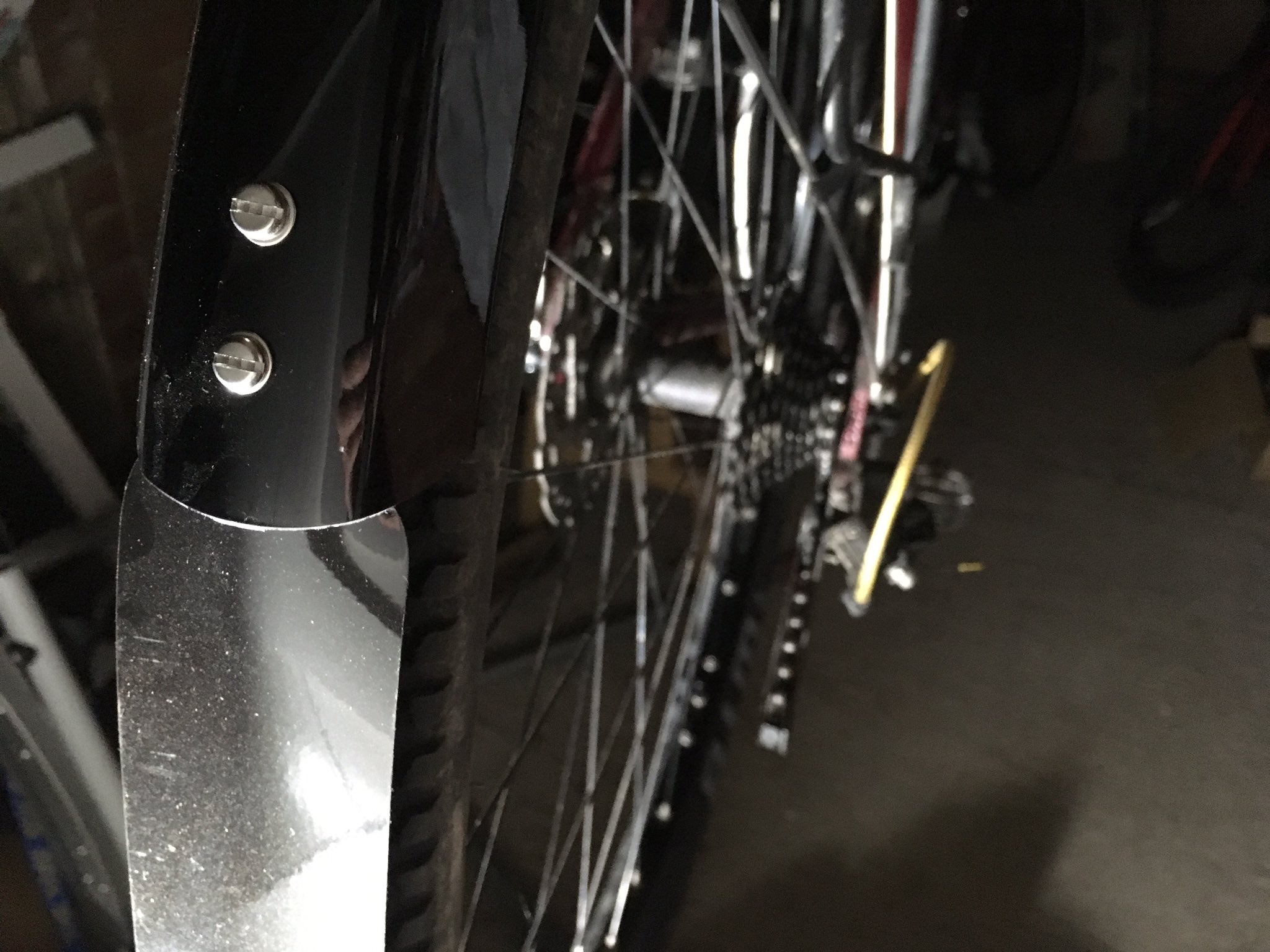

I've got the bluemels guards and 35c GK SKs but haven't fitted them together yet - I'll have a look at the clearance tonight and report.

Posts: 5182
I just fitted some SKS Bluemels (42mm) to the Vagabond.  Seem pretty sturdy and quiet but have not used in anger.  Pictured with 35c Landcruisers there is just enough clearance.

Posted : 03/10/2018 8:50 am
had a quick check - 45mm SKS bluemels and 35(really 37)c Gravelkings = plenty of clearance. It'll depend on your frame to a degree though.
