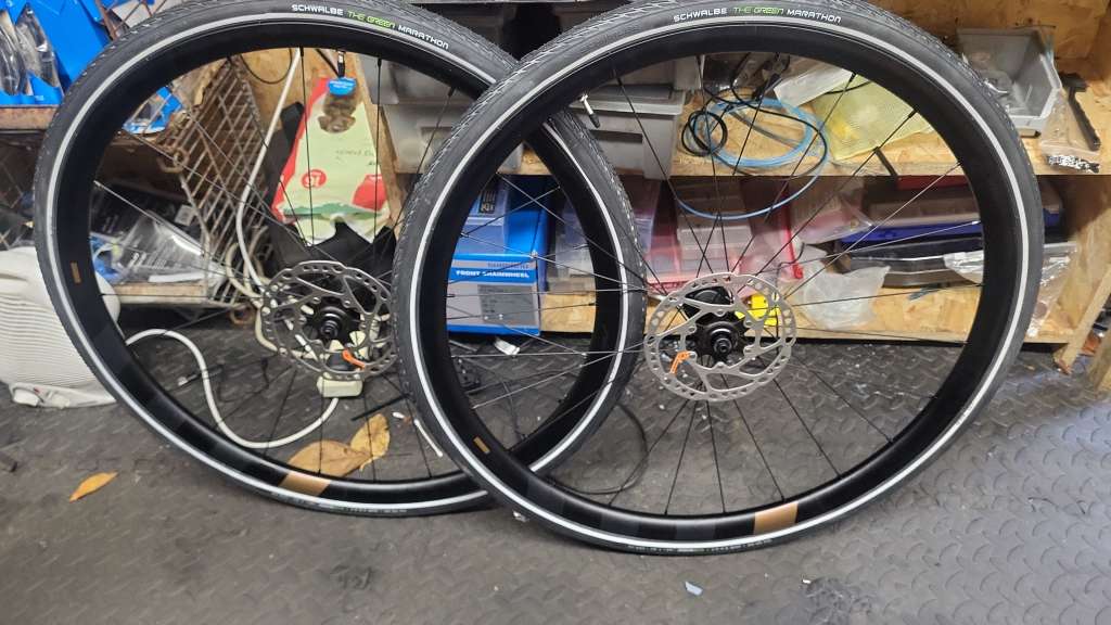

Those prime ones are lovely and a bargain at that price. IMG-20231116-WA0002
