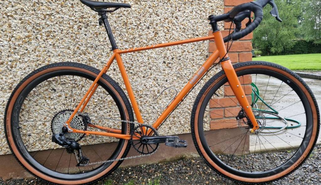

Posts: 13771
I picked up a set of Campag Levante carbon for 900 euro recently, stretching the budget a bit for sure, but they are really lovely things. Quiet hub, finish is lovely, nice and wide (25mm internal), light, seem really comfy to ride compare to my alu Hunts (the way they widen the tyre is a big part of that I'm sure).
