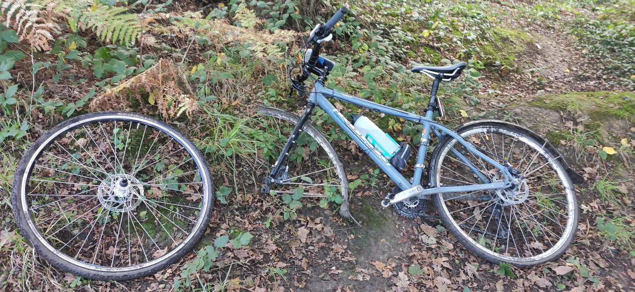

I have a rigid 26 with 29 wheels and Schwalbe cx pro 30c tyres at 50 psi. Today I double pinch flatted on a tiny root. Last week I pinch flatted on a stick.
These wheels are normally used on a full sus with no issues.
People have been riding off road on narrow tyres for years, where am I going wrong?
Are cx wheels narrower and make a taller tyre? Are gravel tyres a lot wider?
Has anyone managed ghetto tubeless on tiny tyres?
I really like the way these tyres slice through mud and the speed on the road so would like to keep the cx aspect of this bike. If the problem is the 29 wheels ,do cx wheels have ye olde mtb wheel spacing?
If you are pinch flatting then you are going wrong with your PSI being too low for a tubed tyre.
I ride 25c tyres off road but they are pumped up 'very hard' (I measure by pressing my thumb on tyre!)

more pressure

50psie is what I run in 40c gravel tyres tubeless to stop pinch flats. For a 30c tyre with tubes you'll have to go higher.

I had my first 'snakebite' flat for years (decades?) on an early ride n my gravel bike running 700x38 at 40psi. It was on a fast descent when I hit a pot hole with the rear wheel.
I have gone tubeless and upped the pressure to 55psi and no problems (hopefully).
Putting 50+ psi in tyres seems strange after running mountain bikes at <20psi for years

This to me is a major part of why the whole 'gravel' thing happened when it did, supple, narrow
tyres off road with tubes is a recipe for pinch flats unless you're running very high pressures of course.
CX was obviously there way beforehand but they ran Tubulars to get round that problem.

How much do you weigh? In any case the answer is more pressure.
Line choices are different. You need to be looking for the smooth bits and hopping things. Very different from a bouncy MTB where you think about grip and carrying speed.
I run tubes.
When using my CX as a gravel bike I use 50+PSI on a 33mm and weigh 75kg.
In a CX race I will drop down to below 30 depending on the course. Anything like roots or rocks and I have to go higher.
In the 3pks I think I ran 70PSI! The max I dared. But that is very rocky.
For CX tubs and tubeless provide some of the answers. For gravel there's a risk of damaging rims if you constantly bounce off things that would have given you pinch flats.

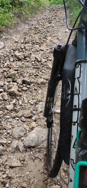

Been thinking about this and in the summer I was riding stuff like this on holiday.
With sus forks I would have been going even faster. Not a flat all week.
Strange.
30c tyres off road is where you are going wrong. Back in the day I used to inflate my 2.1s to 45psi with tubes to avoid pinches. There's a reason MTB tyres started off fat and got fatter.
The 'no, you really CAN ride a gravel bike anywhere!' brigade will turn up now and say 'no, you really CAN ride a gravel bike anywhere!' and this is true, technically, but you do have to go really quite slowly and carefully in many places when the ground is rough. That's why, living in a rocky area, I don't ride a gravel bike for long distance stuff; I opted for a rigid 29er so I could use 2.35" tyres at 23psi.
That kind of trail is not really a pinch flat risk because it's consistently rocky and slow so you go in with an appropriate speed to begin with. And because it's so uneven and loose you're always going to be going slowly on a narrow tired bike anyway. Pinch flats are much more likely when you are zipping along some smooth dirt and there's an exposed root, or a flint nodule or something. Bang!
