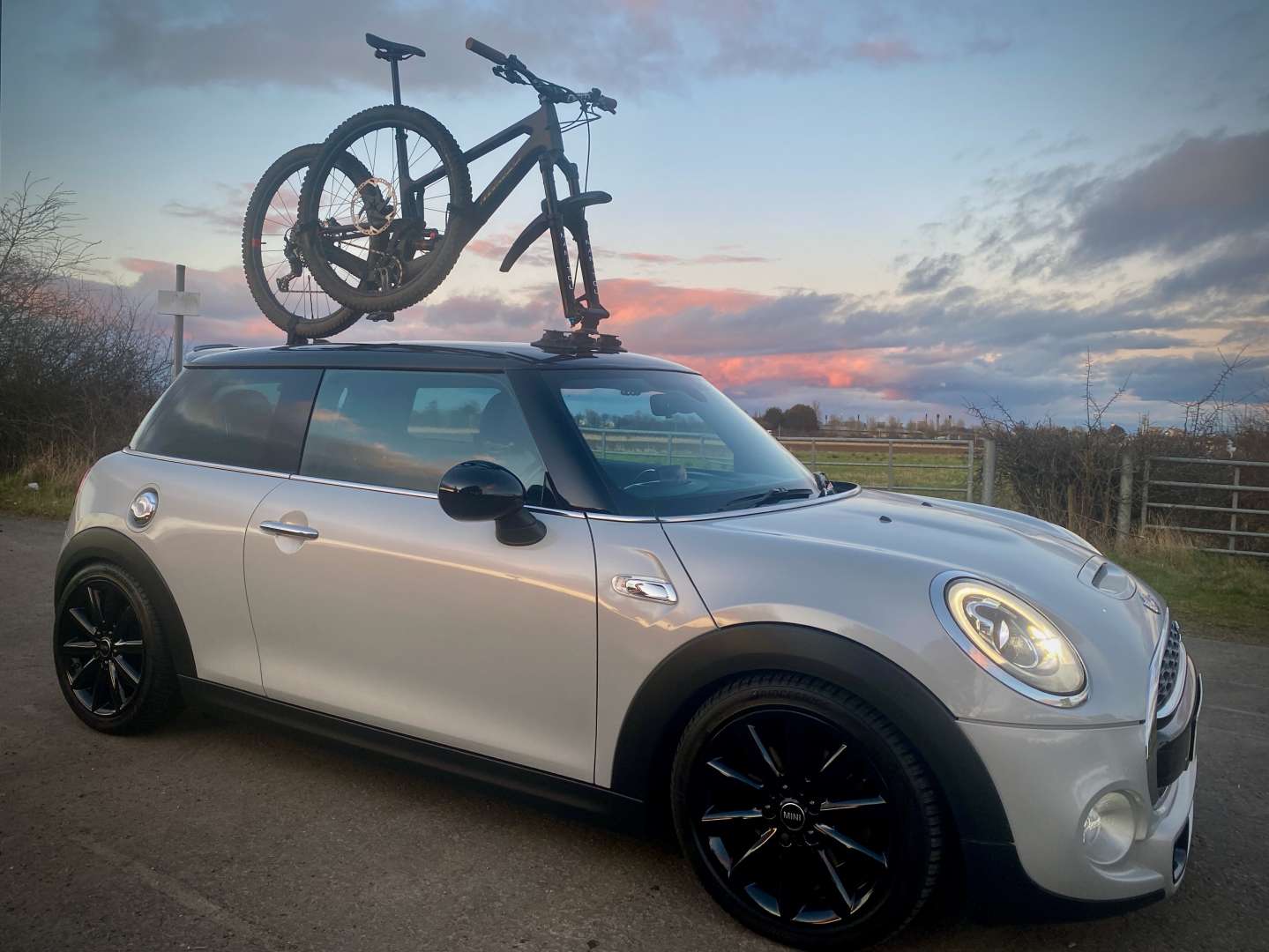

I only use my car occasionally for carrying a bike so went with the suction rack I already had (use a van most of the time).

I actually already have a suction system but:
1. I don't trust anyone else in the family to use it safely
2. The roof panel flex makes me wince

Posted by: reeksy
It's the worst roof flex I've had on any vehicle I've used mine on (including, coincidentally, a Vauxhall/Holden Monaro 😀 ). No damage to mine after quite a few uses.

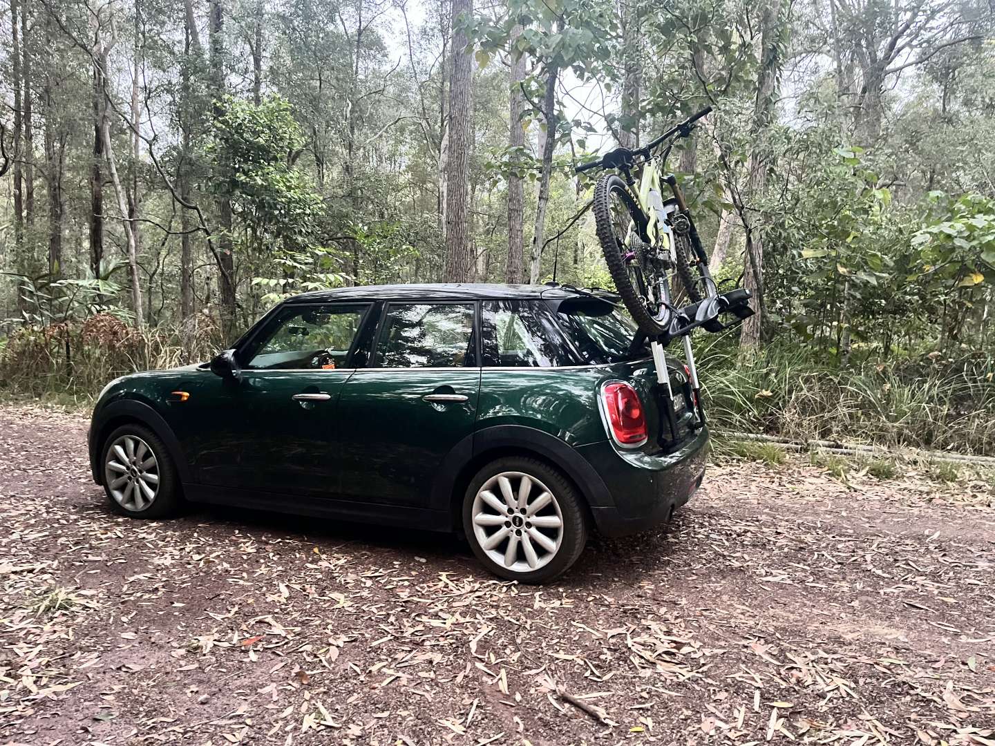

Went with a Thule platform rack in the end. Seems pretty good.

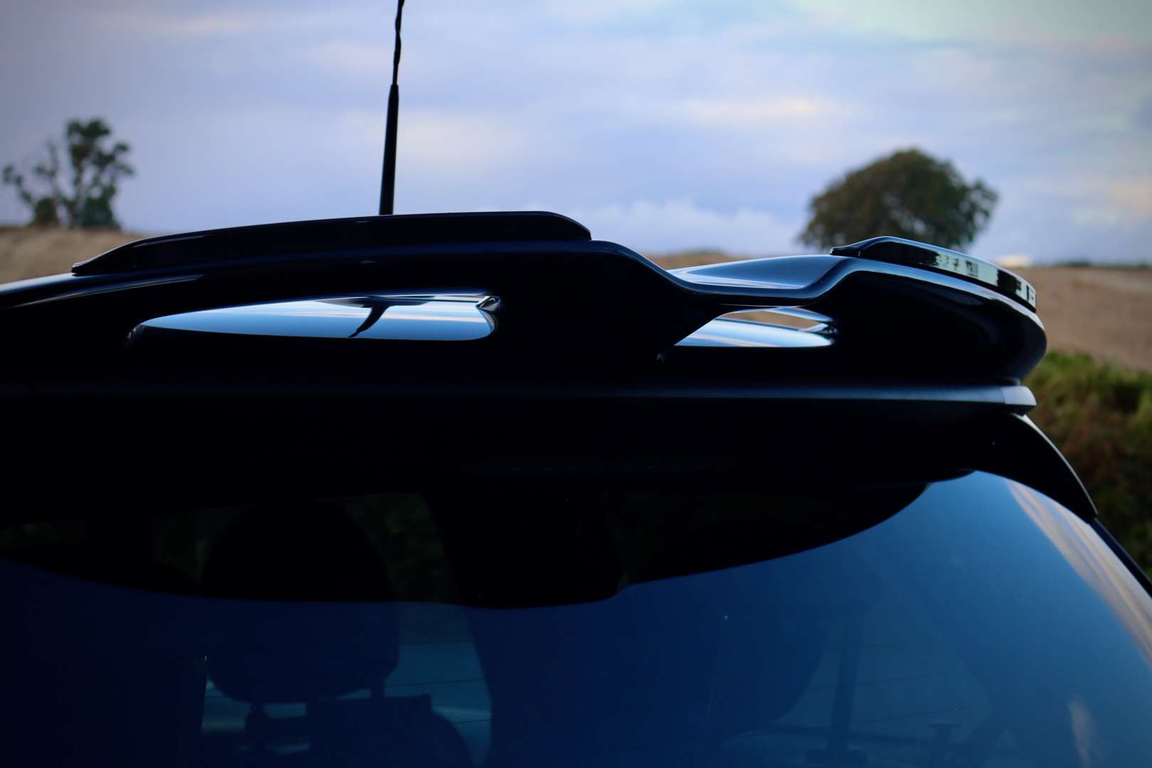

That looks good @reeksy. Keeping a note of this in case I end up in a situation of wanting/needing to use my Mini more often to carry bikes (it's not a cheap option!). I suspect I might have issues with my rear spoiler if I can't thread the top straps/bars through the spoiler gap.

Posts: 7181
That's what I was worried about @a11y but from reading up its only the S spoiler with the lip that should be a problem.
The trickiest part is actually where the legs go past the plate. I need to put some inner tube there to stop it rubbing.

Posts: 7181
Posted by: a11y
Edit: 1270mm max wheelbase! All my bikes are longer than that but could be worked with if it came to it.
I hadn't seen that!!! Mine is 1287mm apparently - probably is a bit longer than ideal, but the straps seem to work fine. I drove for an hour at up to 70mph without any issues.

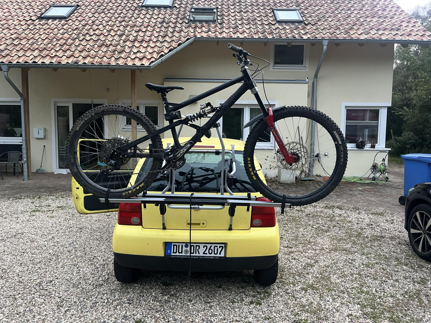

Reminded me of this pic someone posted in a Geometron group recently 😀

Posts: 15305
Silly question, and someone more knowledgeable will no doubt shut me down, but that Lupo appears to have both axles outside the width of the car, meaning theres at least 2 foot of “load” protruding beyond the vehicles bodyline…
Would the rozzers (in the UK) be within their rights to pull you for that? My gut says that’s for to be breaking a rule…
