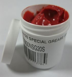

Depends on the hubs and ratchet system. For DT swiss, I use finish line ceramic bearing grease, for hope hubs I use a very small quantity of the TF2 red grease, for Mavic hubs which require mineral oil I use shimano red brake fluid in very small quantities- they suggest filling three teeth on the ratchet when almost upright IIRC

DT Swiss grease. Great for star-ratchet freehubs and pawl freehubs, just use sparingly, you really don't need much 😉
