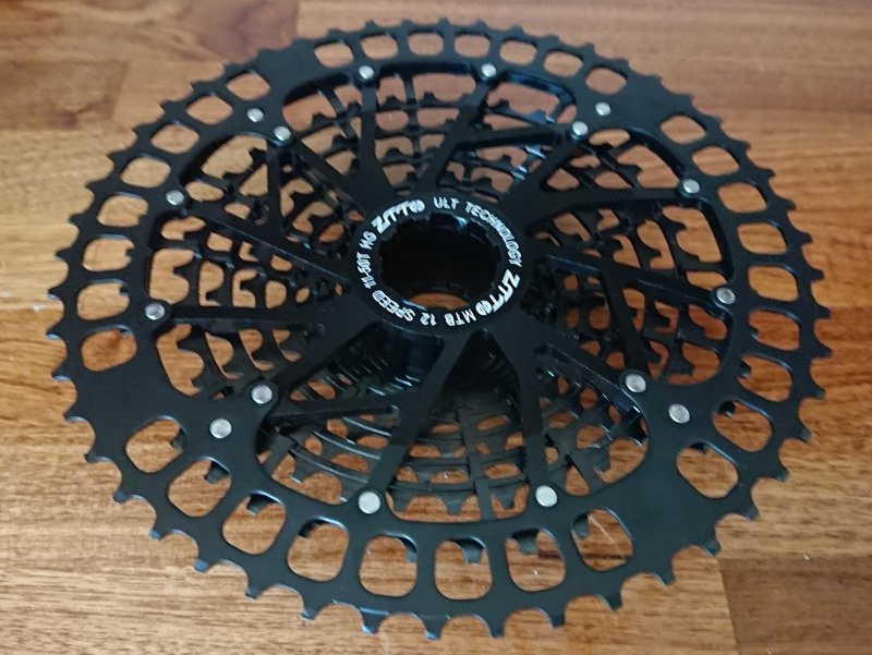

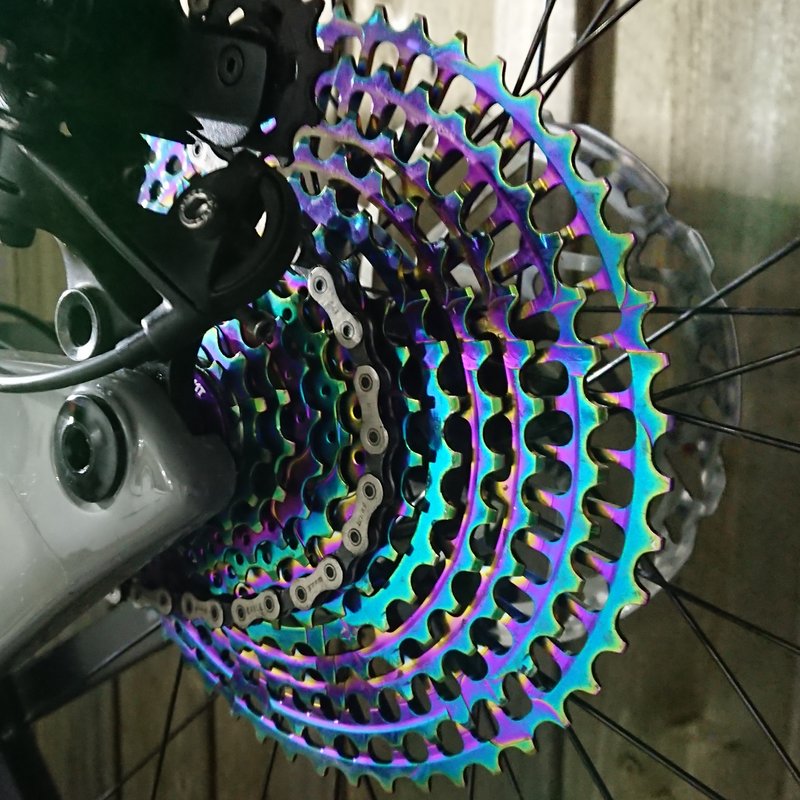

I had been running SRAM GX Eagle cassettes until I got a new wheelset that came with HG freewheel. The cost of an XD freewheel + cassette was getting on for £200 now so I thought I'd try an HG alternative. We'd also been running the above Sunrace HG 11-50 cassettes with no issues ** on a number of bikes but I wanted something a bit more bling for myself! I came across this rainbow cassette from ZTTO (whose dropper levers I've been happy with) which at just over 400g was even lighter and had a slightly wider 11-52T range, coming in less than half the price of switching to genuine SRAM and XD.

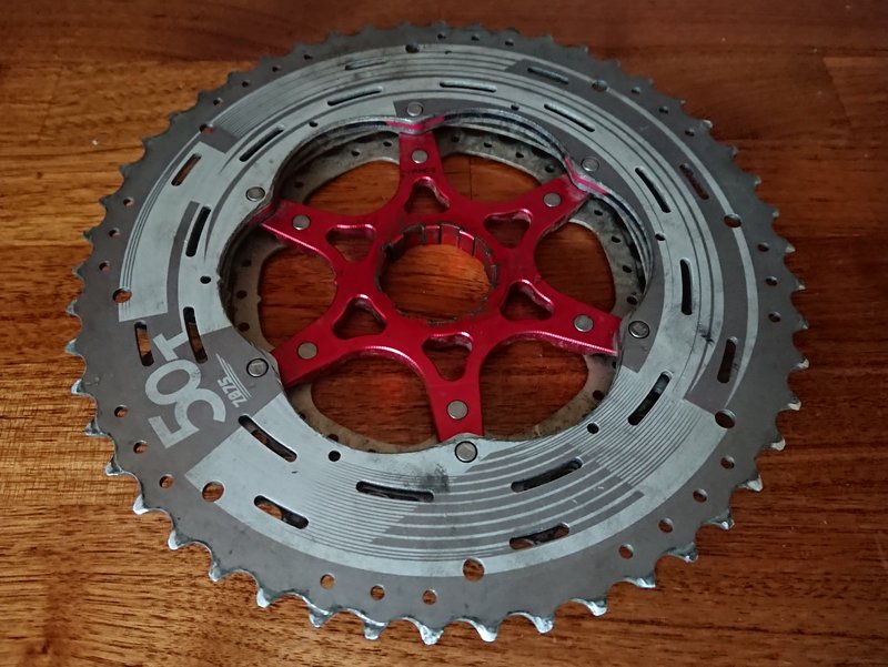

** apart from they don't clear the spokes perfectly on some of non boost wheelsets without a little shaving of the spider with a grinder.
Bling bling, I've also got a matching chainring!

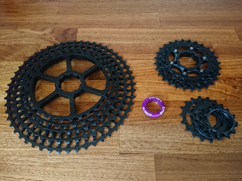

I use a standard SRAM GX Eagle derailleur which had no problem reaching the larger 52T cog and generally shifting has been acceptable. The five largest gears are alloy and the rest steel. Initially fitted with a new chain I had problems with the first alloy ring - the chain would jump out under power - I ended up using a Dremel grinder to make the gap between teeth a bit deeper, this combined with a couple of weeks chain wear things settled down.
After a while though it seemed the cassette was coming loose and rattling. This was solved for a while by just tightening things up, but over time this didn't help. I eventually realised the 11T ring wouldn't tighten any further on the freewheel, so the rings behind were not held securely. I added the thinnest cassette spacer I had (0.8mm I think) to move the cassette out which solved this one. After about 3 months the cassette still looks pretty good, and still shifting acceptably, a little hesitant in one ring but I'm used to it now, and perhaps my other set ups were never perfect either.

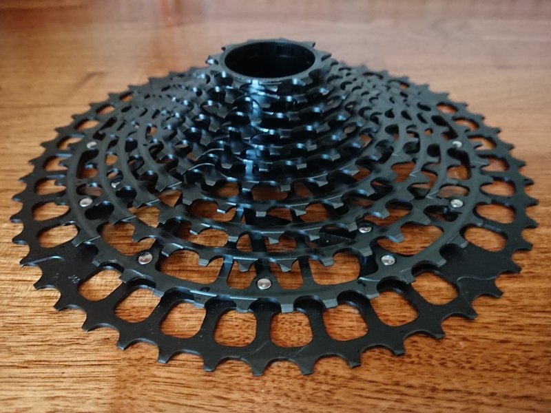

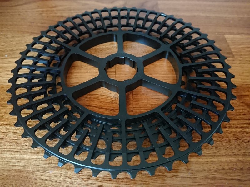

Money being no object I'd probably have gone SRAM and XD as they wear well and reasonably light 450g or so (SRAM HG is over 600g which is a no from me) and while I'm not 100% sold on the quality or longevity of the ZTTO it's good enough. I've already got a black spare from the ZTTO store on AliExpress which came in around £80. While I was on there I also noticed this 11-50T HG cassette which intrigued me as it was one-piece - no loose rings - a similar lightweight 400g and listed as all steel which would be great for longevity. This was about £60 delivered, on arrival though only the largest ring is steel, and the rest alloy. Looks good though it might be a while before I get round to using it!
11-52T in black

One peice 11-52T cassette
Front
Back

Slightly grinded Sunrace spider
Sunrace
