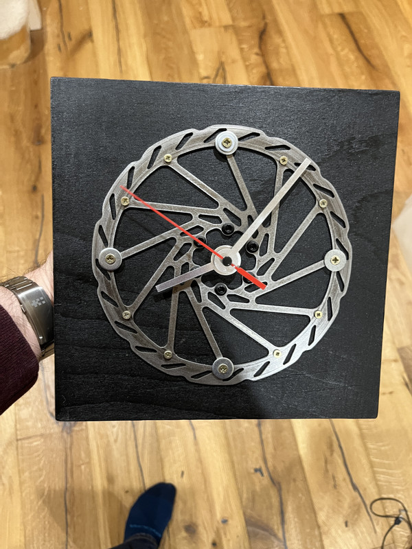

 igm
Posts: 11833
Turn it into a clock for the workshop. Keep using the SRAM.
To be fair, this is a SRAM rotor
Posted : 12/05/2023 9:07 pm
Posts: 1531
Tidy!
Posted : 12/05/2023 9:20 pm
 igm
Posts: 11833
Please note: clock still on GMT
Posted : 12/05/2023 9:44 pm
