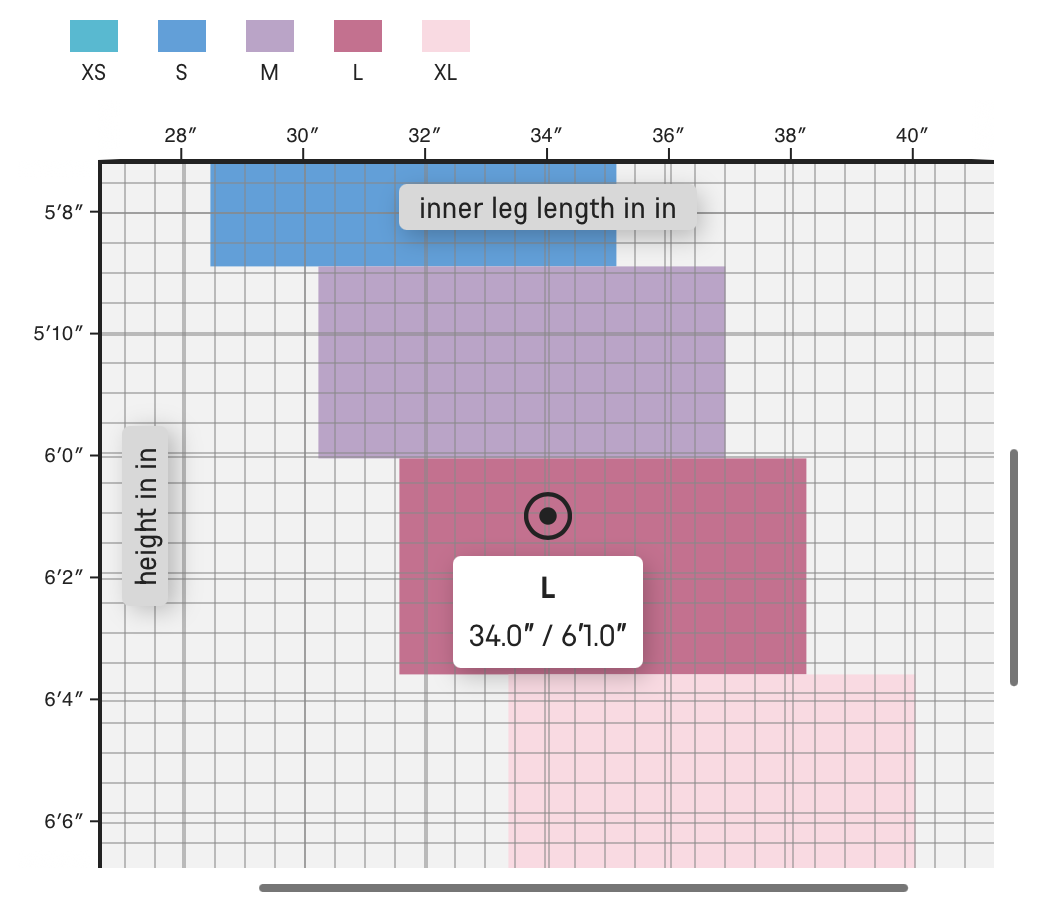

Comparison against the more 'current' bikes (the SC Nomad, Whyte Eltye and Orbea) will be more relevant than your older current bikes. Something like https://www.bike-stats.de/en/ can be a useful tool:
That suggests the large SC Nomad (assuming that's the correct model year as you rode) is midway between a medium and large Neron:ON. My personal approach is generally to size up rather than down, but it's total personal preference.

OK, I'd take Canyon's size finder thing with a BIG pinch of salt as it seems quite conservative. I just put in my stats - 187cm height and 34"inside leg - and it suggests a large for me. Again, personal view, but I'd say even the XL is a bit of the short/small side for me and my preference looking at the geo chart 😀
