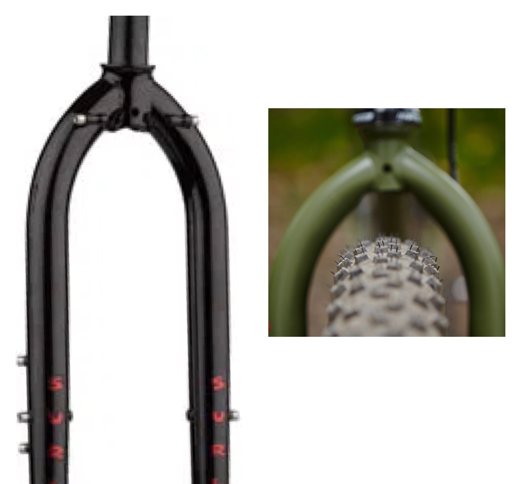

I have a Longitude MK1 and the only mildly annoying issue I have found is with the stock fork legs converging a little narrowly at the crown making a bad match for mudguard clearance. I’m only running 2.1 Race Kings yet can’t fit the front guard high enough to stop it buzzing the tyre on even the smallest bumps.
Can’t find a front-view of the Krampus fork, yet compared to the 2015 Longitude fork here:
taken at an angle the Krampus (L) already looks about as wide at the inner-crown as the Longitude (R) when looking straight-on. Anyone know where I can look at the Krampus fork geo? Could be a nice upgrade if it fits a mudguard and a little taller than the stock fork. Nitpicking tho, as the ‘tude is a great bike!

It is an ECR 29+ fork. It is slightly longer than the stock fork and has a few mm less offset. But it works just fine. The bike is now a bit slacker and with a bit less trail and I think I prefer it that way.
Posted : 10/09/2021 9:28 am
Posts: 712
The Krampus fork is much longer and I think would throw the geometry right out as the Longitude already has a slack seat angle and a middle of the road bb drop. The extra length of the Krampus fork would push the seat angle right back.
Also, the longer fork would put more stress on the frame.

@gowerboy thanks. May be easier to do a little Dremel work on the guard!
