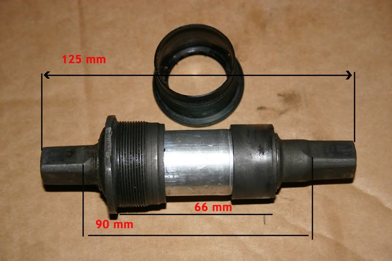

measure end to end of the shafts (ie longest length)
and the width of the bb shell of the bike
post up if you need help sourcing

haha i see... il have a rummage for a diagram on google?
Posted : 27/10/2012 5:26 pm
[url= ]bottom bracket shell[/url]
[url= ]bb measurements[/url]
