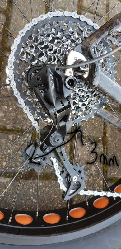

Just change the rear wheel on my kids OnOne fatty , the new wheel has a XD drive...so to save a bit of cash I got the cassette( 10-42), rear mech and gear changer off ebay.
Now it all works perfectly except when in 42....when it's in this it doesn't change down...no matter how many change downs I do...it won't budge.
If I manually pull out the rear mech to replicate the gear change then all works great again...its just that large 42 ring
Anyone else had this?

B tension screw needing adjusted? Top jockey wheel might be so close that it's not allowing the chain to get up and over the top of the cassette tooth?

I’m going for b screw
12 speed has a plastic thing to line it up. Not sure about 11. But there’ll be a YouTube video some where

It's got a new cable...the b screw is all the way in, but it I can get all the gears it's just changing down from the largest where it just stays put.

Mech cage or jockey catching slightly on the cassette in that position? Is the cable actually going slack when you change down? How does the mech feel when you extend it that far off the bike, can you detect any stickiness?

Do you have a gap between the jockey wheel and the 42T sprocket? Is it possible the B screw is all the way in but not up against the tab on the dropout? That is, it’s not pushing against anything. If you unwind the b screw does the derailleur move?

Is the cable routed correctly through the derailleur? I had something similar ages ago and think I’d done something random with the cable not looping through the right holds on the derailleur

Does it need a drop link to lower it away from the 42 tooth, I've had these change perfectly on the stand but then be a proper bar steward when out riding ?

Or if it is the B screw put it in from the back for extra effect.

Sorry for the late reply (work)...finally adjusted the b screw to within 3mm of the 42 ring...works a treat now...thank you to all you guys who said B screw ..you are the best b screw

Do you mean 3mm or 3cm? That looks way too much gap to me, but if it works, maybe it doesn't matter.
Posted : 14/02/2023 11:40 pm
From memory it's supposed to be 12-15mm from the top of the tooth on the pulley wheel to closest tooth on the cassette.
But, if it works, it works.
Posted : 15/02/2023 12:12 am

Soz I should have mentioned that that picture is before I adjusted the B screw...
Sram say 3mm jockey wheel clearance but mine is more like 10mm....but it works , so happy dayz.

Bloody 'ell no wonder it wouldn't change at that angle top pulley has hardly got any chain.(); and I thought I pushed chains and derailleurs to their limits. Ha Ha Ha !
