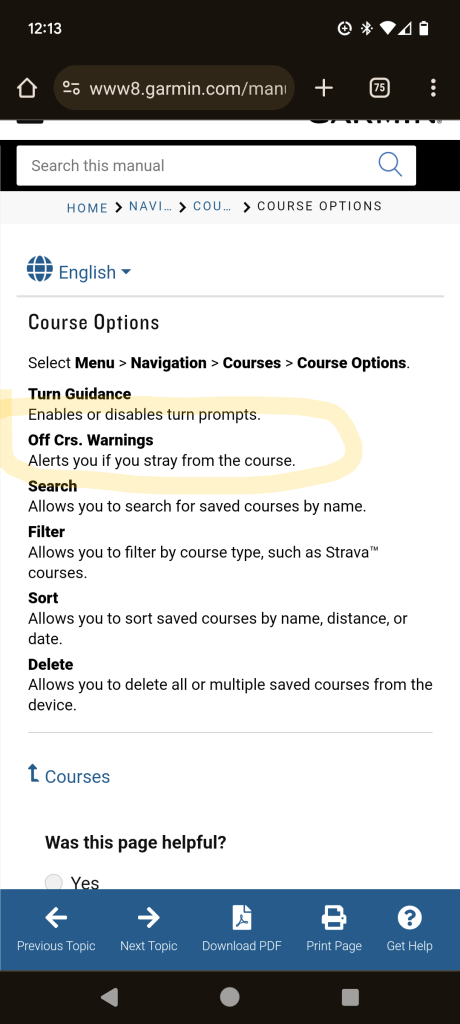

Posts: 1786
Does anyone know what these settings actually do? (i.e. which one stops the infernal "make a U turn" message go away on a 530?)
Screenshot_20240229-121351
