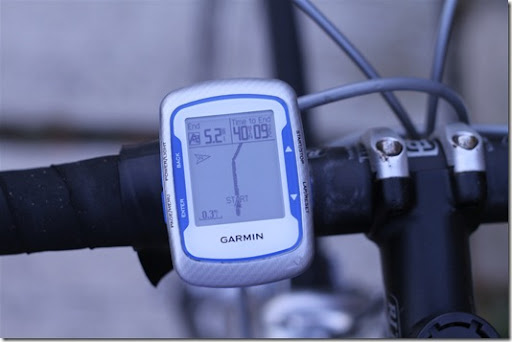

If I were to get a Garmin Edge 500, could I then plot routes on Tracklogs and export them to the Garmin?
I know that the Edge does not have mapping, but would it give me a "breadcrumb" line to follow?

I thought from the reviews that the 500 *does* give a breadcrumb trail in the same way as the Edge 205/305 does? eg. [url= ?imgmax=800]here[/url].
Assuming it does, the way you're proposing to use the Garmin stanley is the same way as I used to use my 205 (and now my 705) - ie. plot route out on Tracklogs and then follow breadcrumb trail...

Ah!
So that picture shows exactly what I was hoping for.
That is an Edge 500, isn't it?
Any idea what format my "course" would need to be in?
