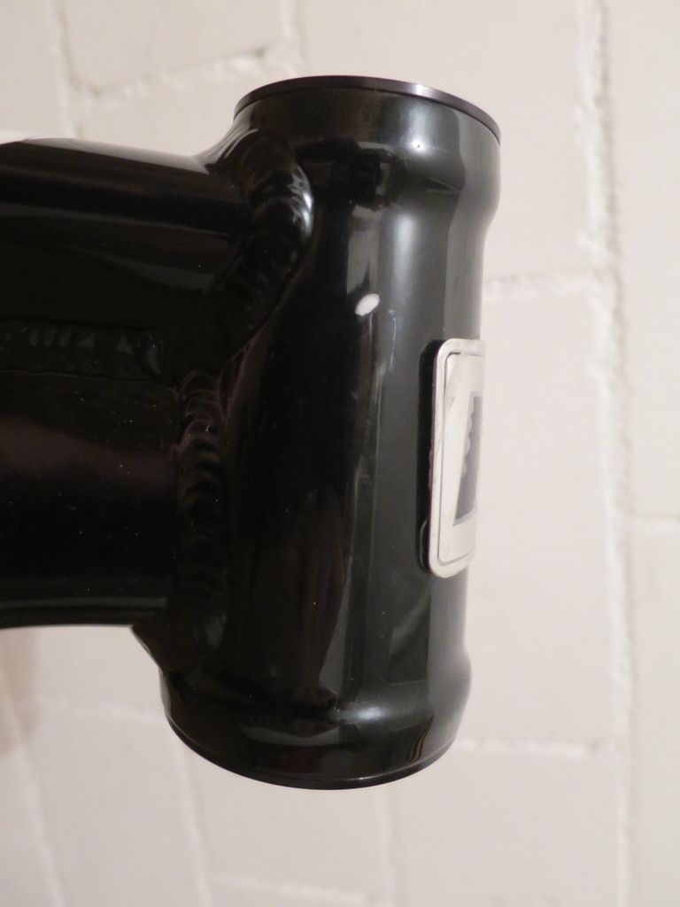

So, I've had these fellas in the freezer overnight.
[URL= http://i212.photobucket.com/albums/cc19/joebloggs77/frosty_zpsvowfwxaf.jp g" target="_blank">http://i212.photobucket.com/albums/cc19/joebloggs77/frosty_zpsvowfwxaf.jp g"/> [/IMG][/URL]

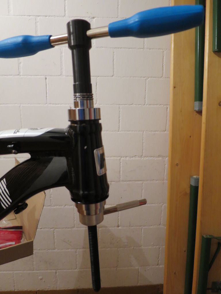

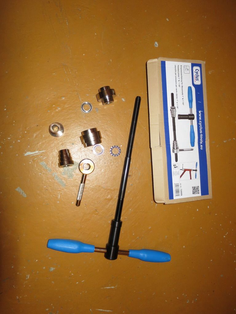

And after advice [url= http://singletrackmag.com/forum/topic/headset-press-for-tapered-steerer ]here[/url] I bought one of these:
It took about 2 minutes and a wipe of copperslip to press them in. Right first time, no faff.
A perfect start to the build.

No. Clean the frame out if it needs it, squidge of oil, one cup in square using the vice and the other one in after the other one. Easy, no pissing about freezing shit and the bike's built 24 hours earlier 😆

A few hours for the cups in the freezer, a wipe of grease and 10 seconds of the mallet sorted a headset earlier this week for me. Didn't want to be splashing out on a tool I'd only use once, got to admit that I was holding my breath while wacking it though. Freezing definitely helps.
