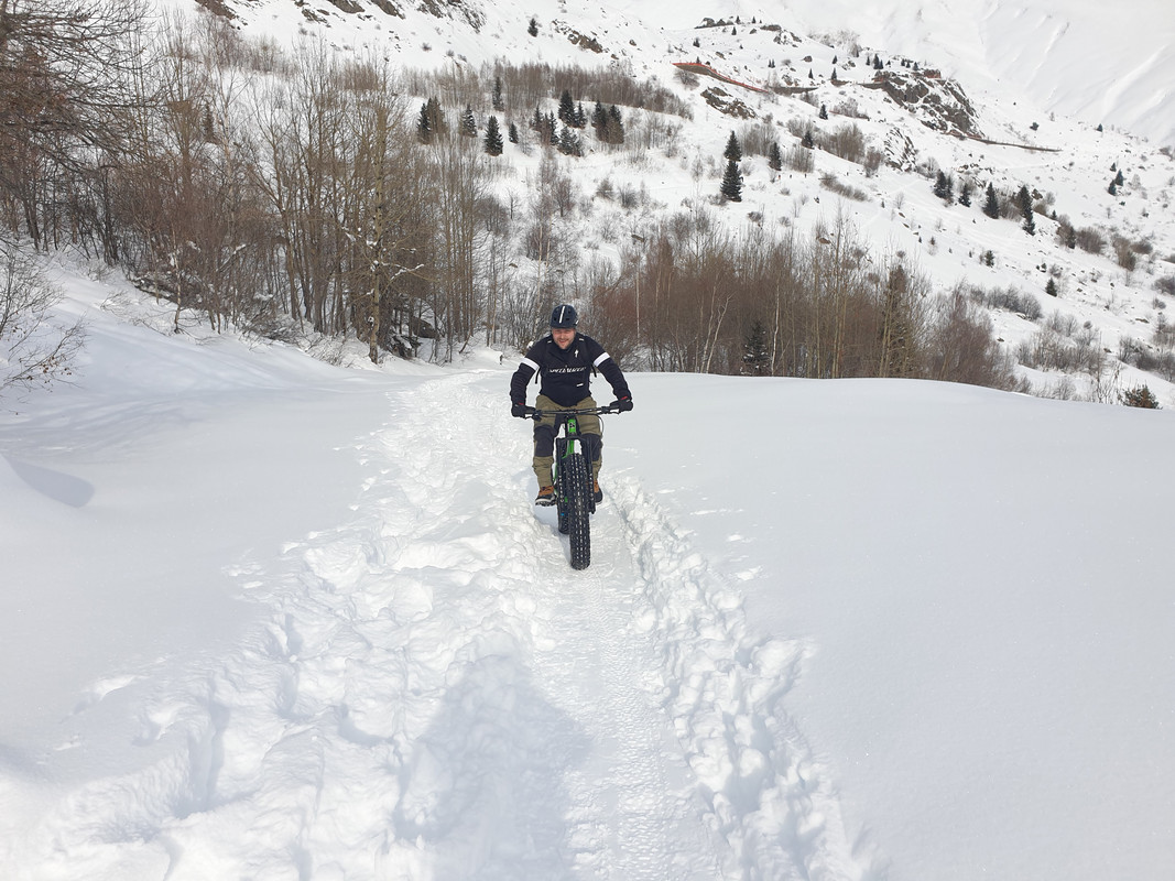

Posts: 6829

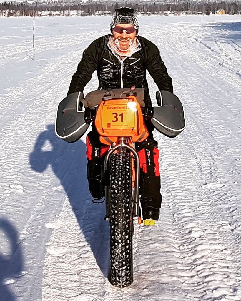

IMG_0741
As said, you really need a prepared track even for fat-biking on snow and generally the wider the tyre the better as this gives you more float - whilst it is the front tyre does most of the work and compacts the snow a little, a skinnier rear tyre will likely just sink or spin. The type of snow and temperature also makes a difference, fresh snow at below zero offers a degree of grip whilst old snow at above zero can just be slippy, horrible and you can still end up pushing.
