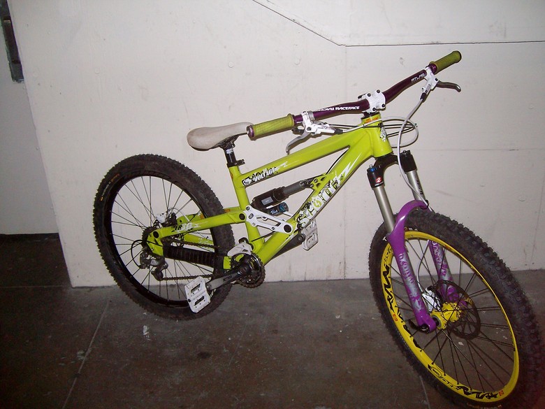

This bike has argyle lowers and u-turn Pike uppers.
[img] ?1294023673[/img]
Take the forks apart, you have nothing too lose. I've seen a few pairs (Although not for a while) like above.
