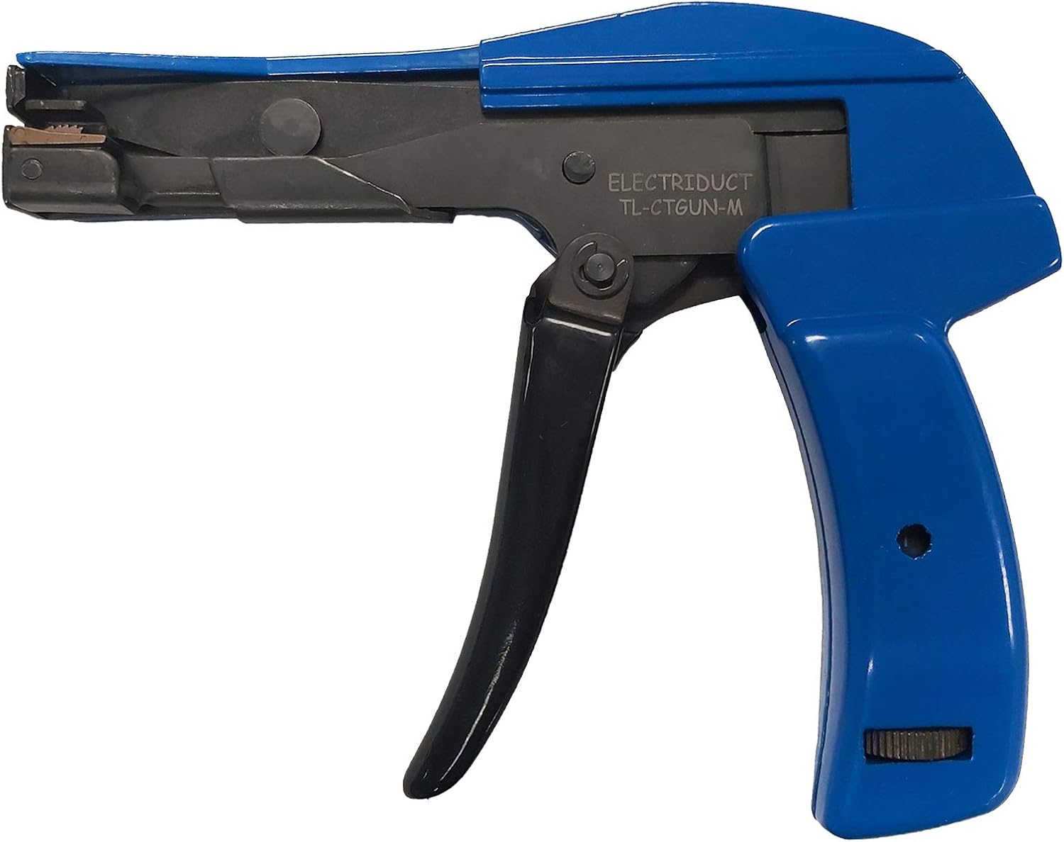

Posts: 357
I use frame protection tape and a zip tie gun to attach the Mudhugger. One of these....
Then the mudguard doesn’t move at all ans hence doesn’t damage the frame.
