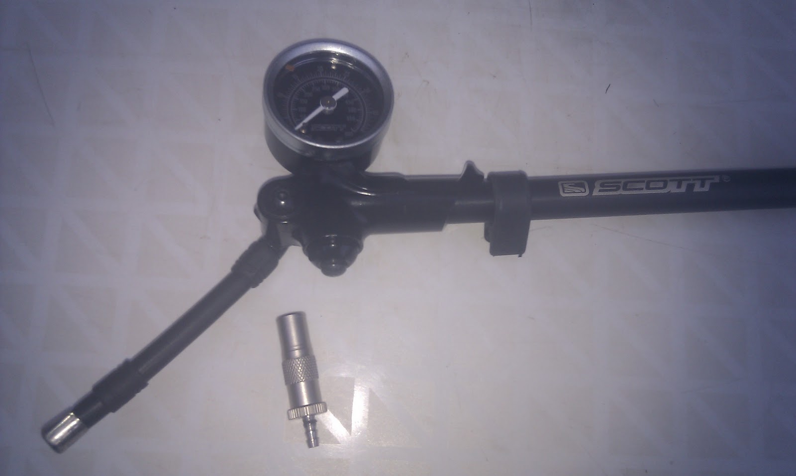

New bike has this shock but I can't set up the pressure. I need a high pressure shock pump that will prevent loss from the valve when removed. Does such a thing exist?
Due to my weight the positive pressure needs to be 450psi, i.e max. When I release the pump I lose about 60psi. I can not put any more than 450psi so I'm snookered at the moment?
Any ideas?

Does the pump really lose pressure when you disconnect it though? I thought that it was just the air inside the pump that makes the psss-noise, and that the loss in air pressure happens when you reconnect the pump.

Scott did a pump specifically for the old pull shocks they used.They went to 500psi and had a valve at the hose end.

I lose about 60PSI at that pressure.

How does that valve work? I need a push on / off to minimise loss when removing.
Screwing it off is too slow at 450psi and loses too much.

Looks like I need one of these..... Cannondale take note. Thanks
http://www.scott-sports.com/global/en/products/2196840001/shock-pump-scott-pro-black/#.UYLYJd5waAY

I used to loose pressure from my shock pump, but since buying one of these I've not had a problem:
http://www.winstanleysbikes.co.uk/product/32095/Topeak_PressureRite_Pump_Valve_Connector?gclid=CJXgp4WG-rYCFe3LtAodB2gASQ
Admittedly I never need to go above about 200psi.
