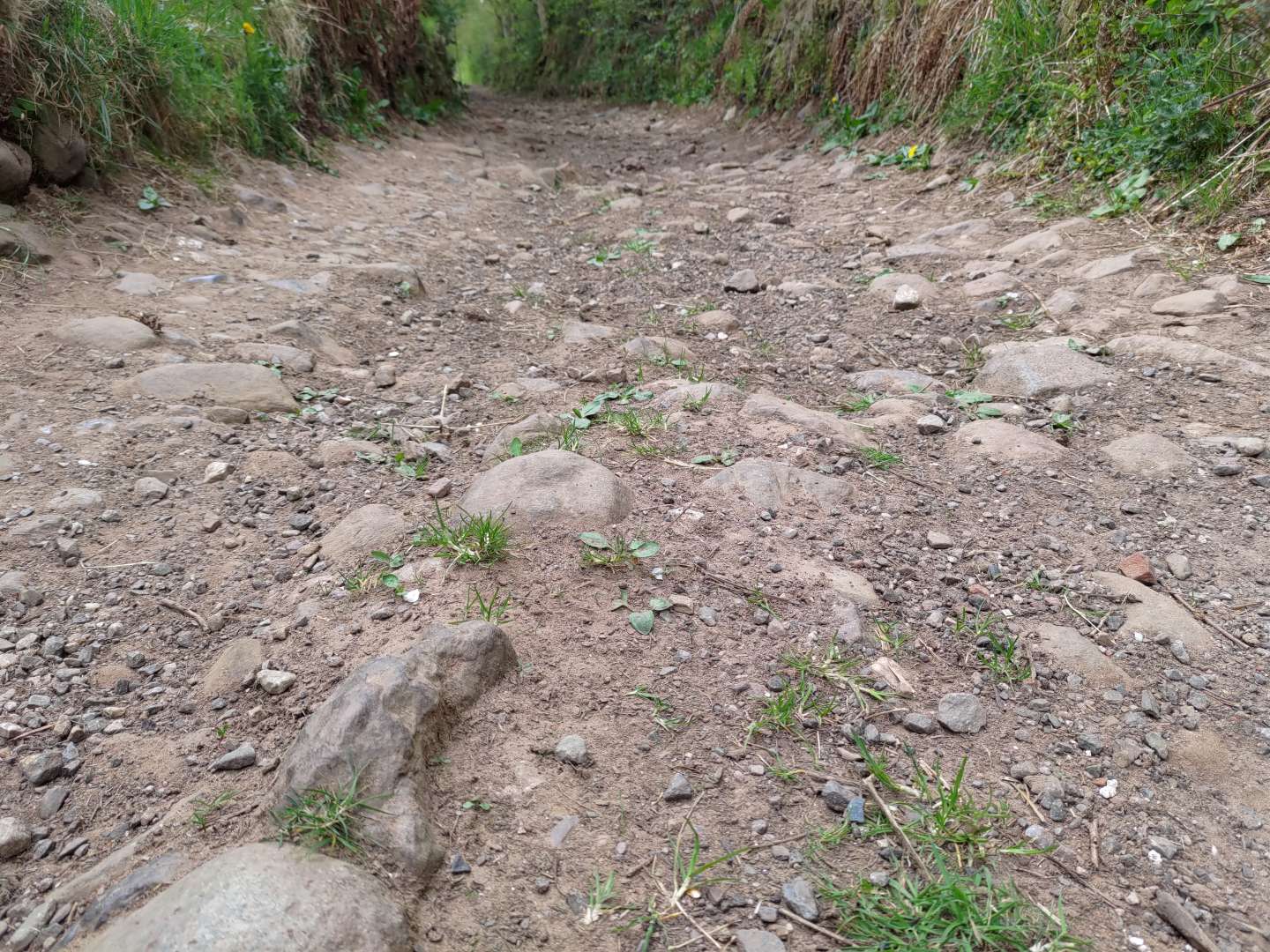

Posts: 3231
I had them checked - too much grease in negative chamber, but bushings were fine, also they bled the damper.
They don't seem to be any better, well I can't do a back to back test anyway.
Brutal on my hands on this track at 30kph/18mph, tried all sorts of settings. Best I got to was 70psi (less and more is worse), rebound -8L/-7H (a bit fast), LSC and HSC full open. Used 120mm of travel which is about what I'd expect.
It's perfectly fine on my normal bike - Selva R, same tyre (Wild Enduro Front Competition Line), 20psi (21psi on the eBike), same insert (Rimpact Original), Pro4/XM481 (Mavic E-Deemax SL o the eBike).
My suspension guy was saying (not about this particular track) I'm running tyres that are too undamped, too low pressure, and the ground/stones may be hitting the insert.
Posted : 27/04/2025 8:07 pm

Rebound as fast as you can get away with as the rebound circuit causes the mud valve to big down.
Posted by: bikesandboots
Looking into what this means, I found that more LSR causes more LSC. I can actually feel it and measure it comparing LSR open vs. closed by pushing down the fork stationary. Wasn't expecting that.
Tried that, doesn't seem any better although it was just during a ride rather than a repeated test.
I'm think I'll take both bikes somewhere to test back to back, to check I'm not imagining things. Or I wonder if those first few weeks with the 36s and evening pains some days have caused me to become more sensitive now.
