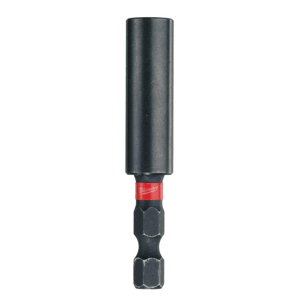

Which tool? I've got some 32SC and the only unusual thing I used to get the lowers off was one of these, which most folk have lying around somewhere (bit holder for a drill).
Fits over the rebound bit that sticks out. Requires care, obviously.

That works with the 32SC as well does it? I've seen that on a guide for the 34s and wasn't sure it would fit. What did you use to extend it with / manoeuvre it into place?

I may have a faulty memory, but I don't recall it being too bad to get into the recess and have enough sticking out to hit with the hammer. Might have to check though!

Mmm, that wouldn't have been a Step Cast fork then. With the driver on the rebound bits it will be right up inside the fork.
Posted : 03/12/2019 11:07 am
It's definitely a Step Cast.
It's possible I had slightly longer driver to hand, although I've just popped a standard one up inside the recess (without removing the rebound knob) and it makes it to the end, just about. Small fingers help though.
Either way, 2 quid will be better than 30-60..
