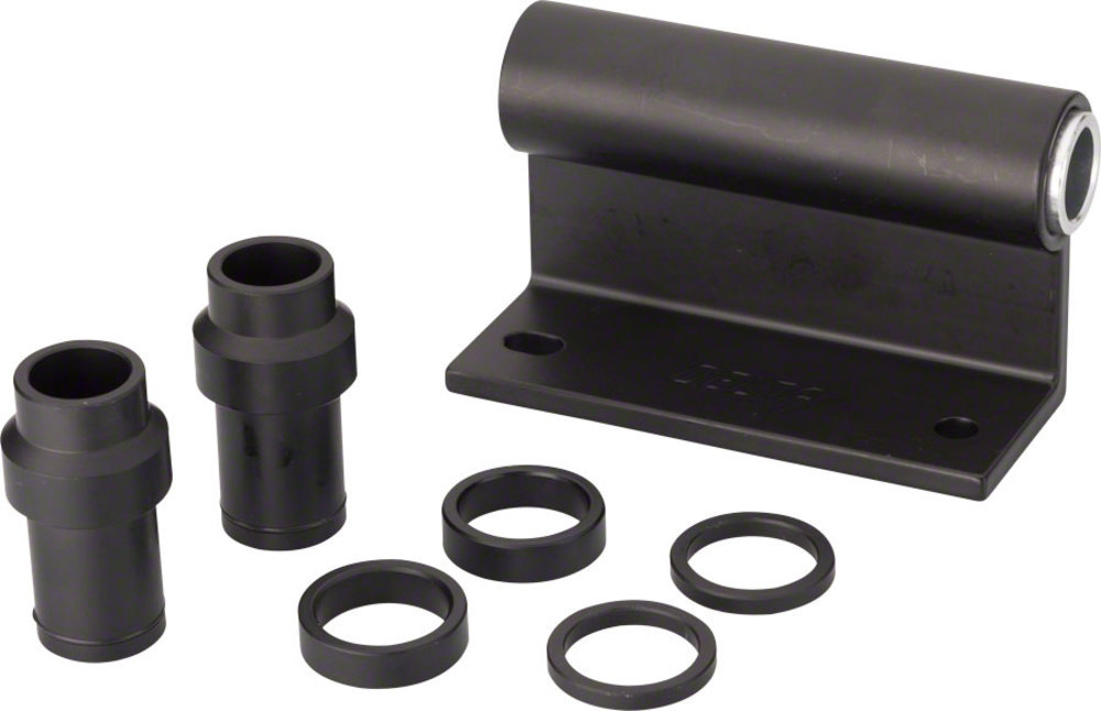

want to have the option of securly transposting bikes inside the van with strapping them aginst the sides and scratching the furniture.
only decent looking option is [url= http://www.ebay.de/itm/New-Delta-Bike-Hitch-Truck-Rail-Fork-Mount-Thru-Axle-15-and-20-mm-/182181453138?_trksid=p2141725.m3641.l6368 ]THIS FROM DELTA[/url], but it is in the states and i'm not sure whether i'll get hit with import duty.
can't find anything that does both 15mm & 20mm forks in one. the Seasucker on CRC comes in either 15mm or 20mm.
any other options?

Get the 20mm and make adaptors.

did think of making my own, but time is tight and i need them in the next two weeks....
have seen this which i thought was a good solution, but as i said time is tight.

Make a simple L like that but drill a 20mm and a 15mm hole next to each other. No messing with adapters. Or you can buy truing stand adapters on ebay or get hold of some 20mm OD pipe with the right bore (or get another piece to slide inside it to get it closer).
Posted : 28/08/2016 9:35 am
Posts: 1617
oh and remember 20mm is 110mm wide. In fact I would make some adapter tubes for boost forks too while you are at it.
If you are in a rush then just get a block of wood and drill a hole through it.
