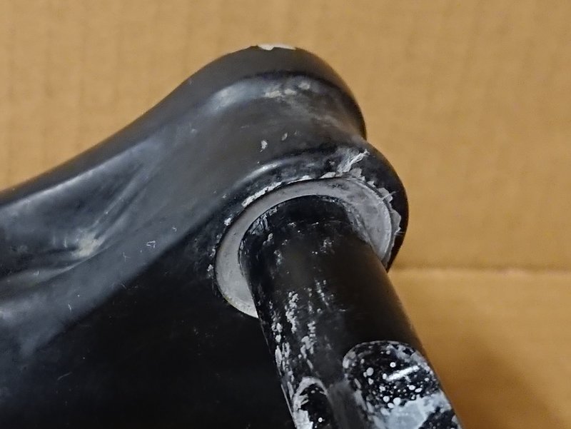

Just putting together a new build and I was surprised by the shape of the fork lugs 15mm thru axle. Normally they always look like following 15mm axle with about 20mm flat area;
fork 1

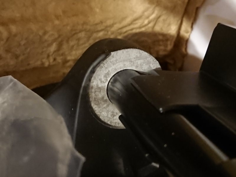

I just got a new fork out 15mm axle but about 28mm flat area;fork 2
The hub looks a little lost in the flat space;fork axleI've got a boost and non boost forks with same lug so it isn't that. One's a Pike the other Lyrik so not that either. Is this normal? Is there a standard I'm not aware of? It'll probably work OK and be held with the axle I'm just used to seeing the hub sit neatly in fork lugs.

I think you need torque caps for the hub
edit : although Sram say you can also use the normal end caps.

Posts: 2314
Ah thanks, just Googled torque caps and it's another standard I wasn't aware of 21mm standard flange 31mm for torque caps fortunately I can get caps for my Stans hub no problem, I'm guessing there may be universal ones too, or just run without as another option.
