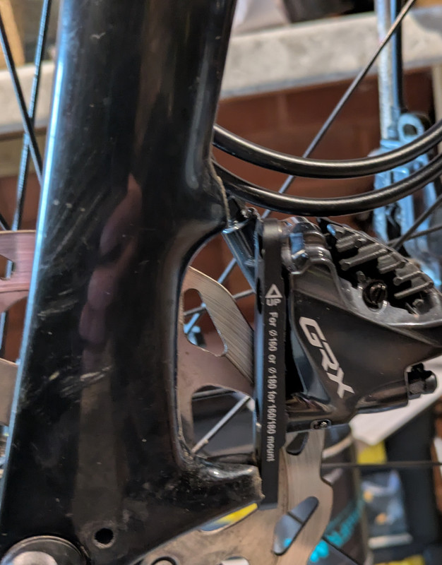

Had to replace my trusty old R685 shift levers, so got the bargain GRX from Merlin. Come with flat mount calipers, thought I'd be able to use adapters to fit these to the Tripster... but no, not the ones I've got anyway (see below).
Is it possible to fit these to the post mount on this bike, or do I need to swap the calipers over?
I have adapters like this, they don't fit (front or rear)

Not many forks (or frames) have the clearance to use these adaptors.
Check out the notes on the AS Solutions one:
https://www.assolutions.ca/flat-mount-caliper-to-post-mount-adapter-guide/
Looking at the calliper, fork and adaptors you have there... take off the adaptor that's on your calliper, and replace it with the ZRACE one... then see if it'll fit. Don't try and use both adaptors together. This is from that guide linked above...

Ah, cheers. Looks like a caliper swap then.

Yeah, tried that, the right angle bit on the adapter just doesn't go into the fork mount, or the rear which has a brace.  I would need those 13mm A.S. ones, but nobody supplies them over here that I can see.
Or bigger rotors. If your frame and fork allow it. It's all a right pain in the arse though... I'd swap callipers.

Update: found adapters on Amazon that fit the frame/fork. Means going 180mm rotors, which as mentioned, may not be supported by Kinesis.. and what with the frame being 10 years+ old (and other Tripster v1s snapping!) I think i'll stick with the caliper swap and keep these as a a backup.

I bought some Zitto adapters for a drop bars MTB that work well. The 160mm version does have quite a big bend and needs plenty of clearance. The 180mm version might work on your forks.
