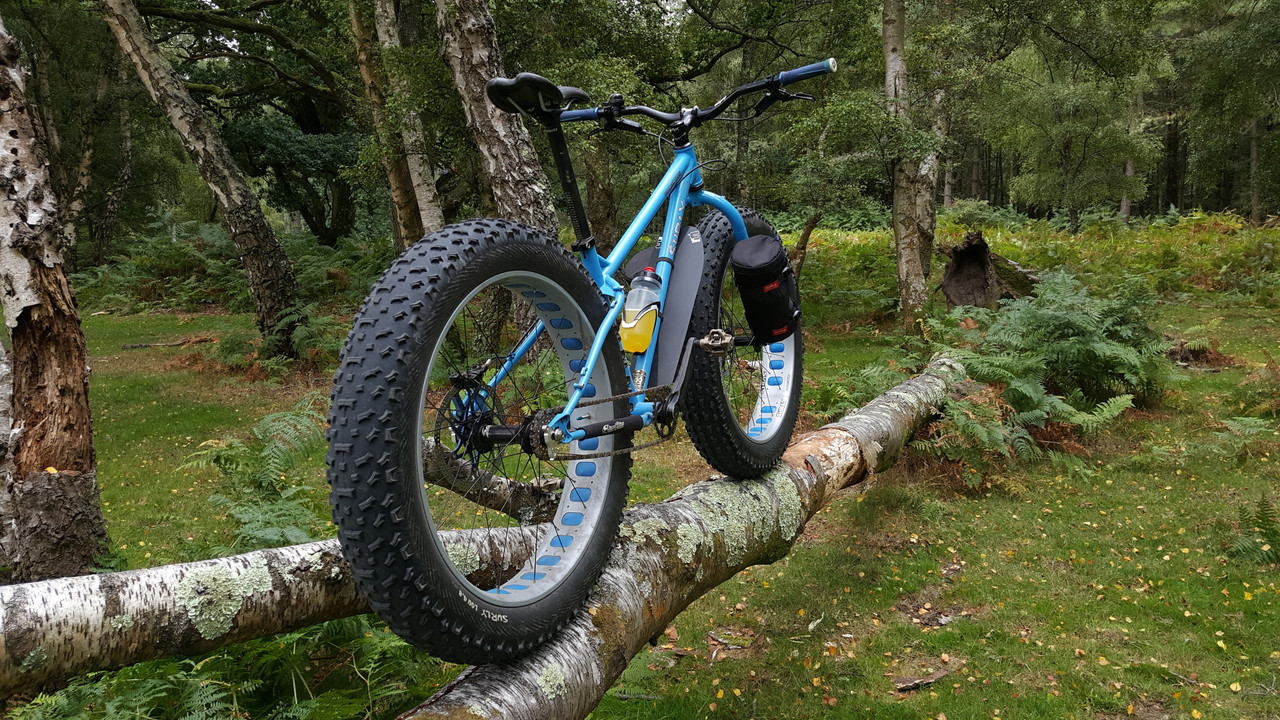

I ran 28:18 for SSUK last year. But then I took 'em all up some big hills and along the beach 😂

Whats cranks have you got on the Surly 40mpg?

Td75 - they are raceface aeffect. Not so many choices when your got a 132mm wide press fit BB!
