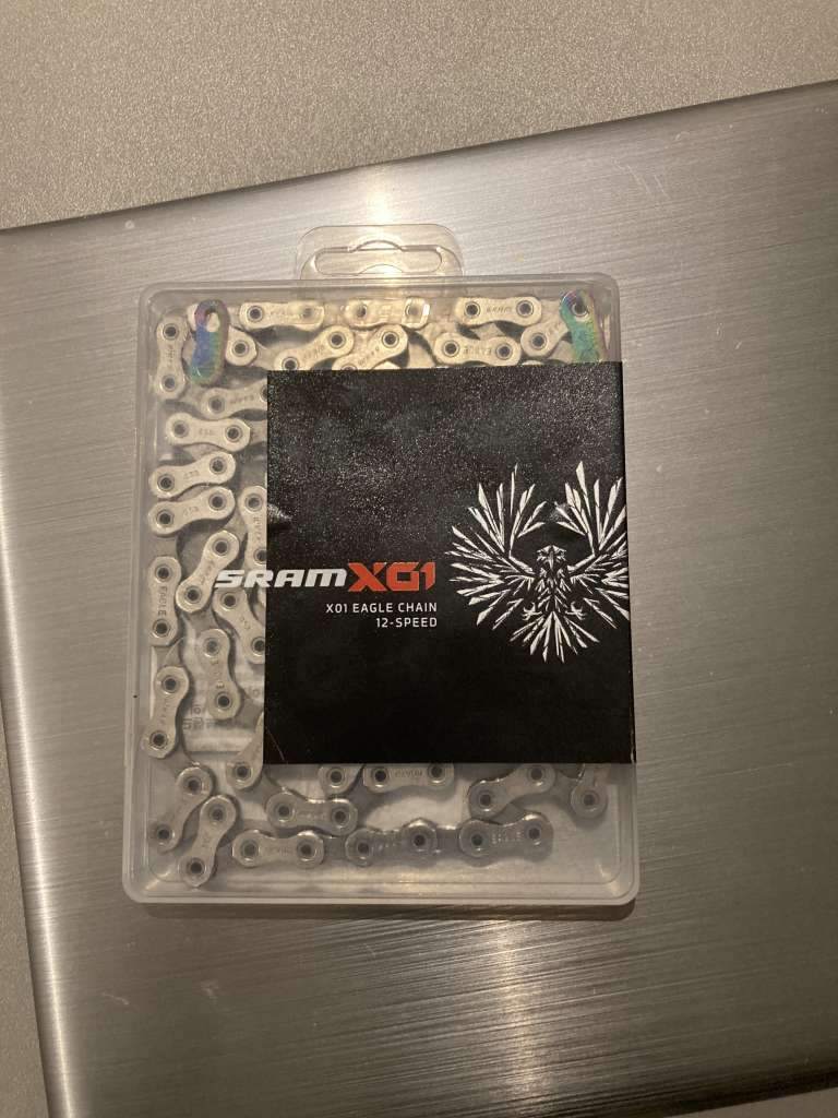

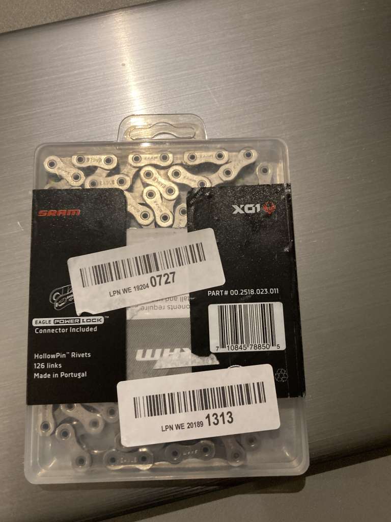

Just to round this out. I reckon its a fake. bought from here looking at it now it obvious really, shouldn't buy things before coffee in the morning.
Couple of pictures of the packaging, on the front you can see the lettering is out of register on the XO1, the chain itself is pretty dirty  but the giveaway is the bar code on the back which is for a black chain.
stupid, hopefully no one will make the mistake I did.

Which barcode is for a black one - the white stickers or the one on the SRAM label?
It looks pretty genuine to me so it's a good fake! The link you posted does say black chain in the description but the pic is of a silver one.. Maybe it is genuine but has been repackaged for some reason...
The SRAM part code 00.2518.023.011 is for a silver chain...
It's got a rainbow connector in it as well. Looks second hand actually rather than fake. Send it back ? Amazon will accept a return. Maybe exchange for another and see if it's the same... The reviews aren't that bad but then they could be fake also.

Which barcode is for a black one – the white stickers or the one on the SRAM label?
The one on the SRAM packaging, I don't know what the two white ones are for. Yeah noticed the part number is for a silver chain, which makes the barcode a bit more suss.
Yeah, maybe. Seems unlikely though? I'll keep it as a spare.
weight is 30g short and it's 11 links short, so maybe second hand or taken off a bike?

I’ve got a brand new X01 I’ve just dug out, same bar code as yours on the SRAM packaging..

@drnosh, the packaging on SRAM chains is easy to peel back and re-seal if you're careful. The chain may be a real one but right now, I can't be sure. I's in the wrong box, it's short a number of links, and dirty, best guess? It's been on a bike and whatever reason its been re-packaged an sold on, and doesn't (for me at least) pass the sniff test. I've changed my mind about keeping it as a spare and I'm returning it.
