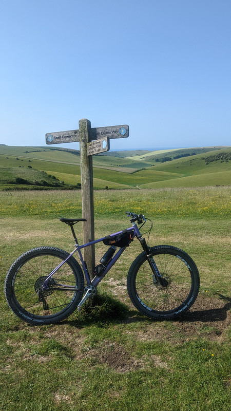

Here's a pic.
Posted : 30/07/2023 10:19 pm

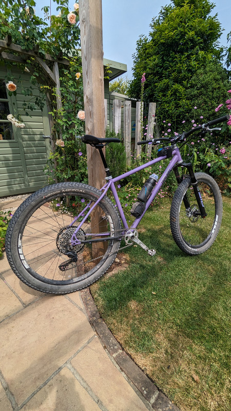

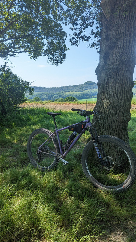

Here are some more
Posted : 30/07/2023 10:44 pm
