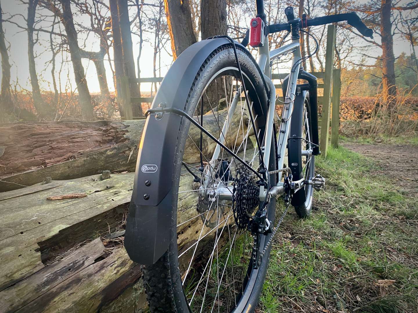

Also, already mentioned above are PDW Full Metal Fenders. I wanted wider tyres on my Cascade so replaced the Edge AL 56s with 29x2.5 PDWs with 29x2.2 RaceKings. Pricy but solid and similar lack of rattle to the Edge ALs. Slightly rounder profile (the flat top isn't as wide as the SKS, with the sides/wings being longer) so might work better for tighter clearance frames.
