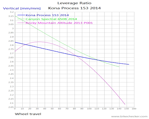

So I stuck an evol can on my avalanche tune dhx air.
Mojo say 17% higher PSI to achieve the same sag
But I've added 25% more and im still a bit saggier than before.
Is that because my process 153 has a linear curve (progressivity is achieved through a low volume air can)
I don't think the evol had a bigger +ve chamber as mojo say it needs 2 sizes less spacers?
Was hoping for a bit more mid stroke support and less pedal bob
But keep the grip I get from the shock
So has anyone else done the evol thing, how much air did you add cheers

you should get more support in the middle due to the higher pressure but also remember your shock is tuned for the standard air curve. you shouldn't require as many spacers as you are running more pressure.
I wouldn't worry about the extra sag as your higher pressure will result in more bottoming out resistance. The only thing you might find is it bobs more.
Posted : 07/03/2017 10:16 am

So an uplift at bmcc and it was feeling really nice, its just the big hits where its too progressive
Its impossible to get full travel , I was running 27.5% extra PSI to keep it at 30% sag
It feels great on berms and small stuff, just bigger hits where Im struggling
I have borrowed a shockwizz and been playing with that, its telling me I need to reduce air pressure but thats taking sag up to 35% and still need to reduce HSC (which is interesting coz Push reckon the opposite for evol/corset) but Its an avalanche tune and that needs to be reshimmed

Sounds like it does actually need a new compression tune...less high speed compression by the sounds of it and stronger low speed valving.
Posted : 01/04/2017 8:20 pm
yeah I just had it serviced by Sprung too, dont fancy shelling out again!
Ill probably put the regular can back on until it needs a service again, shame as it sits up better with the evol
Posted : 01/04/2017 8:25 pm
Nice thing about TF tuned is that if you're not happy with the tune, they'll do it again for you, for free within 30 days....do Sprung?
I'd be inclined to run it and not worry about using max travel, how much are you getting? If you're using all but the last 10-15 percent then just consider that as in reserve for landings to flat.
Posted : 01/04/2017 8:31 pm
ha! Just been out on my 'urban enduro' route, doding the kids having spliffs in the underpasses
wound off the lsc and a few big drops to flat and riding/ jumping down some steps had me using 90% of travel
which as you say is nice to have in reserve, pretty much decided I was happy now
shockwizz saying im
try and squeeze in a proper ride tomorrow at somepoint
Im going to email jake at sprung as he was very helpful, the piggyback has a Nitrogen charge, im wondering If i can drop a few psi and see if that helps
Posted : 01/04/2017 9:30 pm
Yeah that will do it as well, the reservoirs act as secondary springs - adding bottom out resistance - which is why the out DHX models had the external reservoir volume adjustment for bottom out control.
Posted : 01/04/2017 9:58 pm
