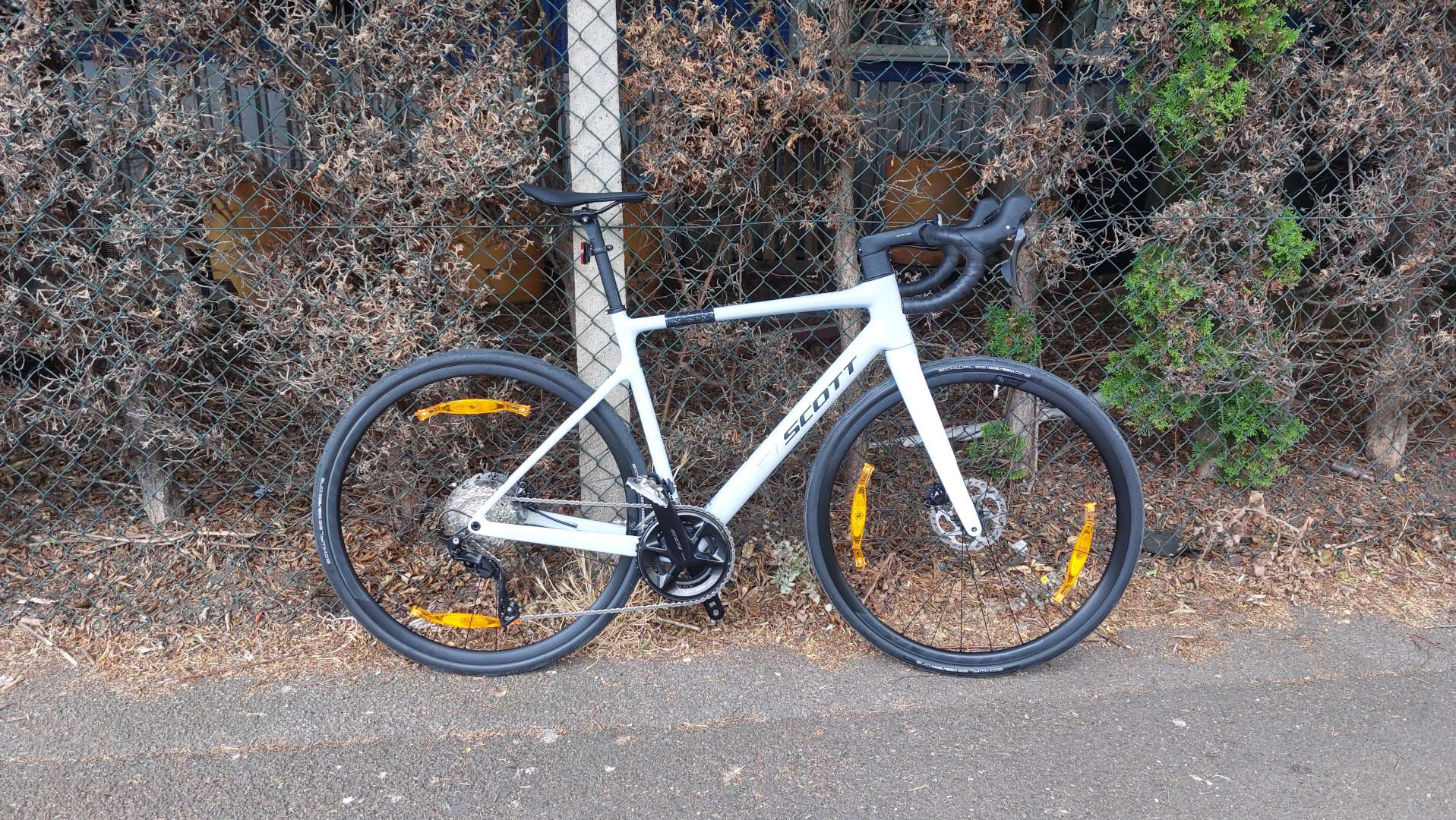

I tried out a Scott Addict in Medium today and feel it's borderline whether it's long enough. I tried a Large over a year ago and very confidently ruled it out for being too long. With <5mm difference in reach I certainly wasn't expecting M to feel significantly shorter. (But the seat tube is also 0.5 degree steeper on the M, so the difference makes sense now). Stock is non-existent so I can't easily try a large again alongside.
This is how it looked with a seat position I liked: Seatpost pretty high (but still not "too" high) and saddle most of the way back in the rails. Feel like I could remove a spacer or two.  Stem is already 110mm.
Decided I'll go back next week with my current bike for a side by side comparison, though they are very different bikes (10 year old steel Charge Plug).  I'm mostly interested in all day comfort - which current bike provides - but hoping to inject a bit more speed.
I've already ruled out an Orbea Orca where I felt I fell between the 53 and 55.
Buying on Cycle2work too, so strictly speaking shouldn't be selling it too soon if I get it wrong.

Definitely remove a few spacers if you're flexible enough. With lower bars it won't feel as short
How tall are you and what top tube length is it?

~20mm difference in HT and ST length, 0.5 degree less STA - looks like you'd be better off on the L judging from your saddle height there. Unless those stem spacers were there just-because on a demo bike and you want 120-odd mm bar drop. How high is that saddle, 800mm maybe more? You're well over 6' I'm guessing?
There's only 5mm of reach between the sizes and that's within STI position on the bars sort of difference, it's not a difference I'd be bothered by either way. So there's maybe 12mm of saddle to bar reach inc the STA change (edit - 15mm of ETT according to the chart). I'd say that's a fairly small (or normal) gap between 2 sizes. 20mm on the ST isn't that much either, 20mm stack gap is normal.

110mm isnt long for a road stem. Try a 120mm or a 130mm. Even 140mm would be fine.

It's worth looking at the bars. The depth of the bar can vary between bikes, a different bar could be used to adjust the position a little.

Can you not get a Large and just run a shorter stem?  I think my road bike has a 75mm RaceFace MTB stem on it and it rides as nice as the longer one that came with it.
Personally I prefer a road bigger road bike with less seat post sticking out and a shorter stem to get the same measurements as I don’t care as much about standover on a road bike as less likely to have to quickly hop off and smash my nuts (compared to an MTB).
But then maybe I’m just a bit odd.
Or if you’re between sizes then it might be worth looking at a completely different bike/brand altogether

Longer stem. Probably a pain to swap on the bike but that’s cable integration for you. I prefer a smaller frame and longer stem as more weight is over the front wheel improving the handling. Pros. Ride the same often for lower stack. I did one winter ride a bike two sizes too small with a 140 stem, just to see, and it was fine.

Well I decided to go for the Medium on Monday, but other than a 10min spin on some local streets I've yet to try it out since bringing it home.
2 things helped plump for that decision:
  • The measured seatpost to head tube and seatpost to bar measurements were both 10mm longer than my current setup
  • The shop had conveniently taken delivery of a fully built size Large that morning, so I was able to try both side-by-side.  The large definitely felt too stretched.  Albeit we didn't try slamming the saddle fully forward, and it had a layback post on it compare to straight on the size M
I've since discovered one of the differences to current bike is something I'd completely overlooked: My old bike has a more traditional 90mm reach bar, whilst the new one is a more modern 75mm shallow drop.  So I should only be about 5mm away from something familiar.  Waiting on some 1 1/4" headset spacers to allow me to test dropping the bar, and still need to play with saddle position. Will experiment with an old post with some a slight setback and see if that's preferable.
