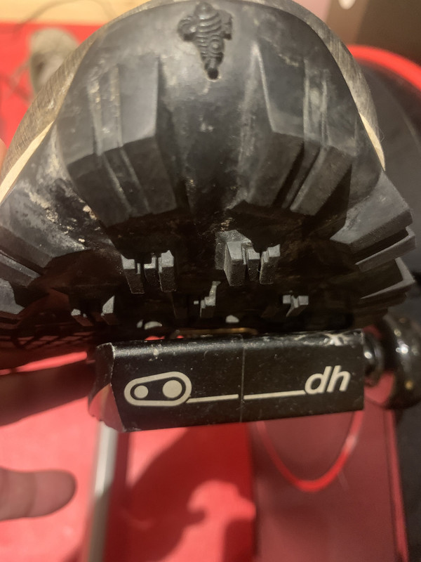

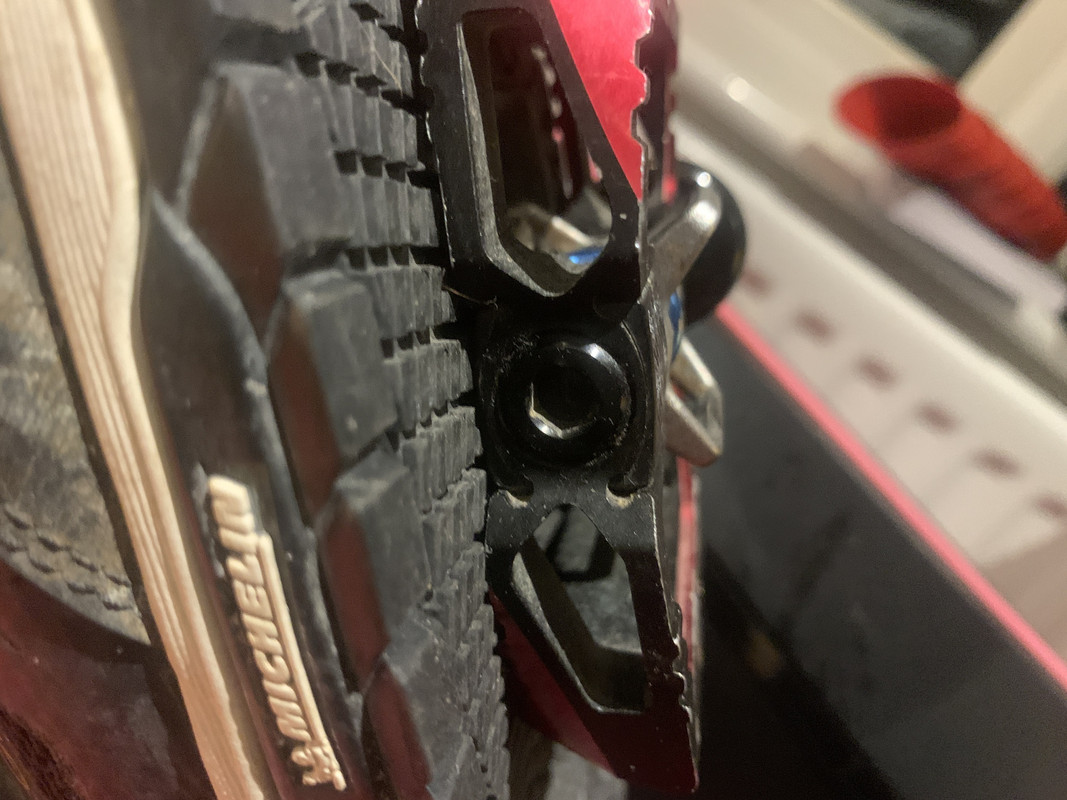

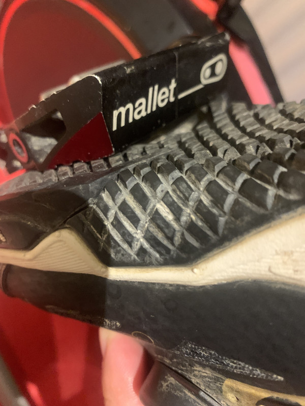

Posts: 1041
Back View
Back View
Front View
Here you go @ta11pau1 as you can see from the side and back view there is no room for pins. On the front you could have a row as there is some space there between pedal and shoe.
Posted : 07/09/2022 10:45 pm
Posts: 5661
Cheers @johnjn2000 yeah that does look pretty tight! Have you got any shims under the cleats?
Posted : 08/09/2022 12:45 am
Posts: 1041
@ta11pau1, yes. Without them I struggled to get clipped in at all.

Quick update, got a pair of mallet e LS pedals and just today had a pair of Endura MT500 Burner shoes, after ordering a size too small and having to return them.
No cleat shims needed, and with the pins wound half way in there's no issues unclipping - well there wouldn't be if my legs weren't proper duck footed - I'm going to order the easy release (10 degree) cleats which have 6 degrees of float, the standard 15 degree release angle + the 6 degrees of float is a bit too much. Tempted by the 0 degree float but don't think that would be very comfortable.
I'll have a play with the pins and traction pads but there's plenty or room for raising the pins a bit.
