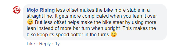

The offset thing? Seems the majority of the industry doesn't understand it. Have ridden 46 & 51 on the same bike, couldn't tell the difference. Found the snippet below on the Mojo page when they were talking about the MORC crowns, food for though and at some point when I'm near a CAD workstation will have a doodle and make a model.
null
