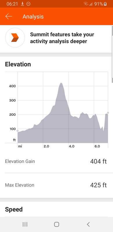

Posts: 695
I'm keen to find the 'correct elevation' function, but can't see it. Do you need to be on a computer rather than the app? Or need Summit? Or am I just looking in the wrong place?
Posted : 27/09/2019 6:25 am
Not sure on the app, try logging in via the webpage (might have to go to the desktop site not the mobile page). It flags the elevation figure with a little symbol if its suspect (i.e. uncorrected).

@Spin - indeed!
On the web page on a desktop computer when you open up the activity underneath the figure of elevation gain is a link with the text "Elevation(?)" click that it brings up a pop-up with a button to correct elevation. There's also a link to this help page - https://support.strava.com/hc/en-us/articles/216919447-Elevation-for-Your-Activity
