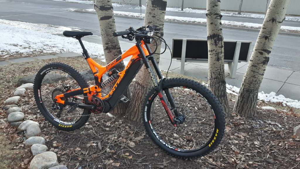

Something like this would be awesome on an old DH bike. I think the mid mounted motor might take a battering though.
https://www.emtbforums.com/threads/bbshd-intense-951-hyper-e-bike.19718/
20201220_160946
