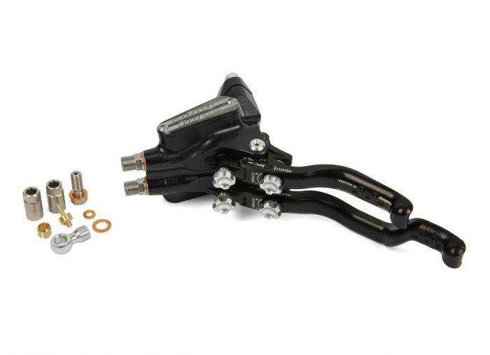

Hope do a twin system.
duofullblk

Hope do a single lever, double caliper setup, called the UNO, Tech 3 lever and 2 X2 calipers for about £290ish
