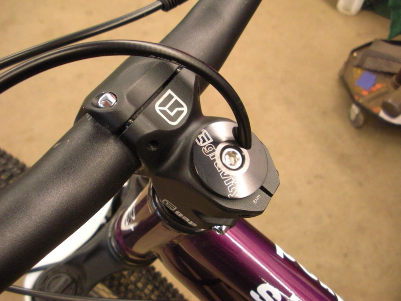

Posts: 1510
Ha. I just had this same question and really tidied mine up, by running the cable down through the fork steerer using a bmx giro stem cap. Works a treat and the cable is out of the way.
I then use rubber o rings to secure the cable to the fork.
[url= http://www.chainreactioncycles.com/gusset-hole-in-the-head-star-nut-top-cap/rp-prod23953 ]Hollow stem cap star nut[/url]

Posts: 8612
I was wondering about that, too - I'd worked out I could get a hollow SFN but didn't know about top caps.
Posted : 04/08/2014 1:05 pm
Posts: 8612
top caps
Like these?
[url= http://ep1.pinkbike.org/p4pb7405670/p4pb7405670.jp g" target="_blank">http://ep1.pinkbike.org/p4pb7405670/p4pb7405670.jp g"/> [/img][/url]
Posted : 04/08/2014 7:15 pm
Posts: 1510
Similar. The link in my post shows you the cap. On reflection I think that one looks neater as the hex bolt is inset rather than proud like the one I purchased.
Still, I think both provide a neater solution to routing the cable
Posted : 05/08/2014 7:19 am
