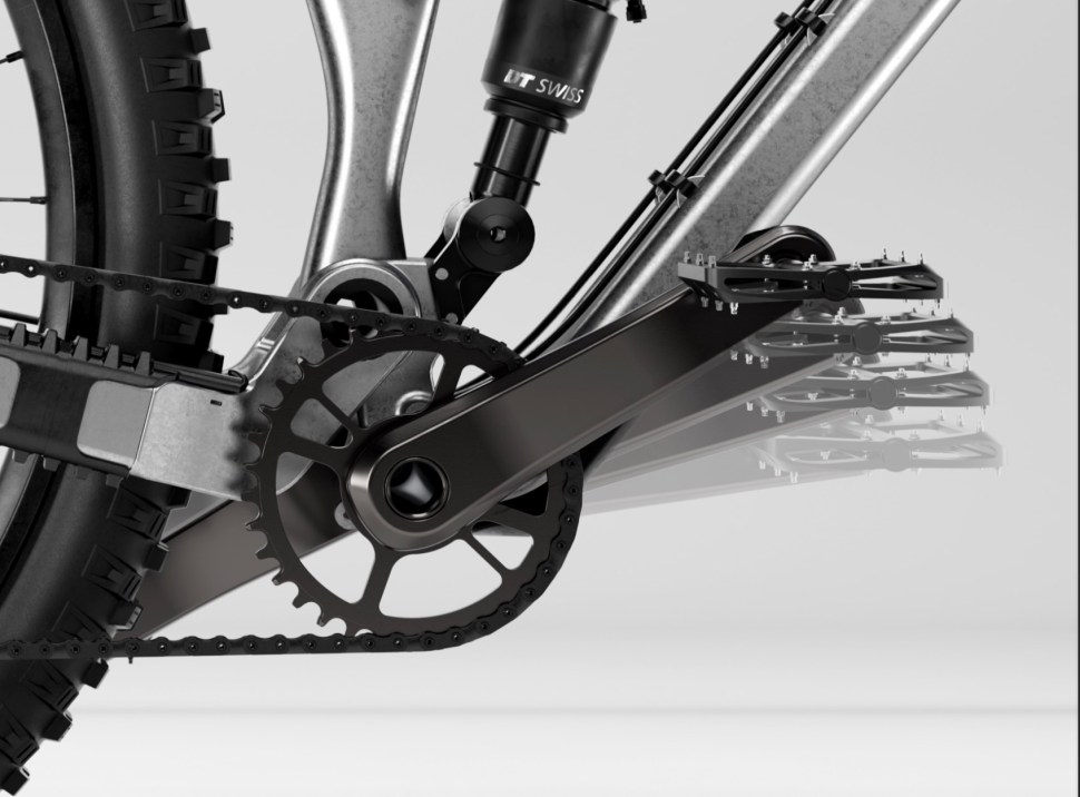

wpf-cross-image
Choose your float: 0°, 10° or 20°. Retrofittable to all DT Ratchet DEG rear hubs too.

I’m inclined to agree with chakaping and this DT Swiss hub seems like a very simple solution.
A friend of mine recently got. Tairin silent hub, then promptly broke his collarbone. He probably won’t get much time on it to give an opinion before winter.
Tairin are a small Canadian company who, as far as I can tell, were the first to bring this kind of hub to market.
one thing that would concern me about these kind of hubs is how many degrees you’d need to turn the crank to reengage the freehub.

Possibly. It depends on what you enjoy about mountain biking.
as an experiment you could remove your chan at the top of a descent (preferably one that doesn’t require much pedalling) and feel the difference it make to the suspension when it is isolated from the chain.
A question I have is what setting changes you’d need to make to the shock to cater for the unencumbered movement? Presumably you’d need to increase the compression damping
Another question is how these changes would impact the performance of the suspension while climbing?
perhaps we’ll see shocks with “descend” switches rather than “climb” switches so that you can firm thing up for when the drivetrain is disengaged!
Non-issue on steady climbs, not sure about normal techy climbs yet, but a bit annoying on very janky rocky climbs (I did Ullswater singletrack a few weeks ago).

That's why I fitted a Rimpact Chain Damper to my Airdrop Edit MX. They were more honest about aiming to mitigate chain-flappyness than trying to make unprovable claims about pedal kick-back.
My honest review is that it works exactly as advertised. Effects will vary from bike to bike but it's eliminated chain noise for me and removed a load of vibration and feedback from my pedals which I didn't even realise was there. For the steep, chunky trails I like to ride it's perfect.
As luck would have it, my other bike has DT Swiss hubs compatible with this new gadget so I might be able to test both side by side.

Maybe not, the DT system seems to be like the internals of an impact driver, the internal ratchet just floats back 0/10/20deg then needs to be pulled forward to engage.
Whereas free coasters rely on a helical driver pulling the 'clutch' together.  The advantage of that design is it disengages completely the other way. There would be zero pedal kickback because without a ratchet you can spin the wheel backwards indefinitely without the pedals moving, it needs pedaling chain tension to engage it.
Actually, wouldn't Shimano's Sylence hub design achieve the same thing as the DT?  The idea was that you had to pedal forward a fixed amount to bring the ratchets together?
