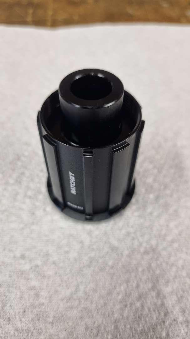

OP. If you do buy the xr1700 and find yourself looking on eBay for the microspline freehub there is a seller selling some as if they are the real thing but they are most definitely fakes. The pictures are on a dark wooden surface, seller is called jdmparts-uk. Avoid at all costs, they do not fit and are poor quality.

@stanley no worries, still happy to send the XD driver over as I won't need it
@nixie thanks for the heads up, I no longer buy any parts off ebay or amazon because there's so many fakes.
