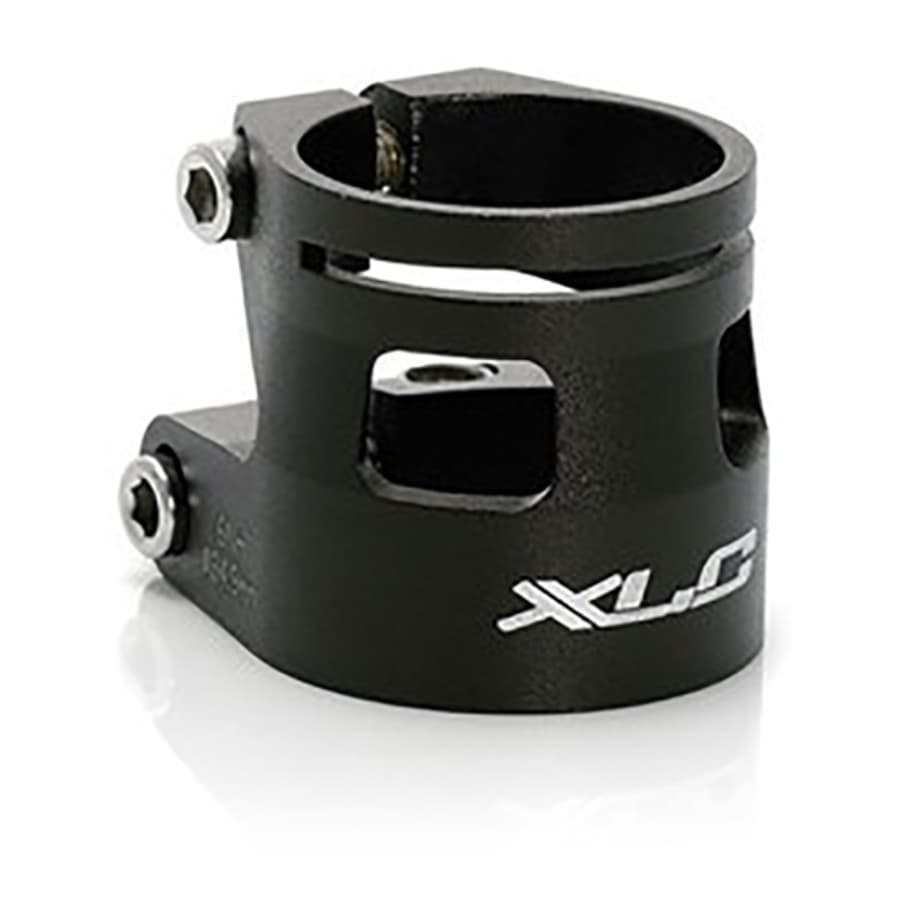

Posts: 3300
if that doesn't work, try one of these: https://www.deporvillage.net/saddle-clamp-xlc-pc-b04-31-6-34-9mm-black
xlc clamp
or a posher version: https://www.tradeinn.com/bikeinn/en/kcnc-mtb-sc-13-twin-clamp/136899532
kcnc clamp
