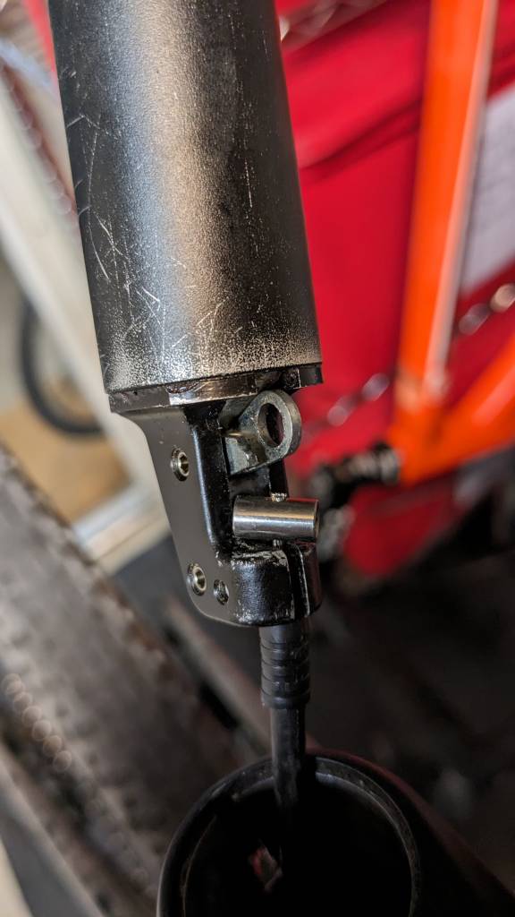

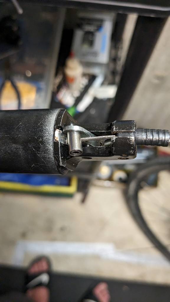

What a pain in the arse this has turned out to be...it turns out that whoever built the bike cut the front brake hose so short that I had to drop the forks out to get the stem off the steerer so free up some more slack in the dropper cable🤷
Anyway, this is what I found....

So...is this just a poor design? The "toggle" doesn't sit securely in the release mechanism and it's very easy to get dislodged.
I've pulled the dropper for now and replaced it with a regular seatpost but not sure whether I can "fix" the poor design to make it more secure.
Do other droppers use better cable attachment points and could I swap this part out?
This is a cheap KS eTen dropper but it's the only one I can find which has layback (and as I've got a very long spine, I need the extra room...)
Ideas??

Looks a bit ordinary - I can't tell if the second ring has sheared or it's supposed to only have one. If so it clearly isn't enough. If not, you should be able to get that part. There's an ebay KS parts seller IIRC if you can't source anywhere else.
EDIT - second look that seems to be the design doesn't it. Nicely arranged to fall out when you're trying to set it up 🙁

Posts: 6312
You can buy that bit from KS.
Its not expensive

Posts: 4267
Looks like one half of the actuator lever arm has snapped off - at least KS are good with spares (IME).
Perhaps when moving the bike around, turning it upside down, the remote lever was caught and put a large load through the remote lever and pulled the cable, snapping the actuator lever.

 StuF
Posts: 2068
agree with Kahurangi, my xfusion on has a similar arrangement but it's a hook on one side and a loop on the other - looks like your hook has snapped off

Yeah, that's broken. You can confirm it by holding the bike upside down and seeing what drops out...

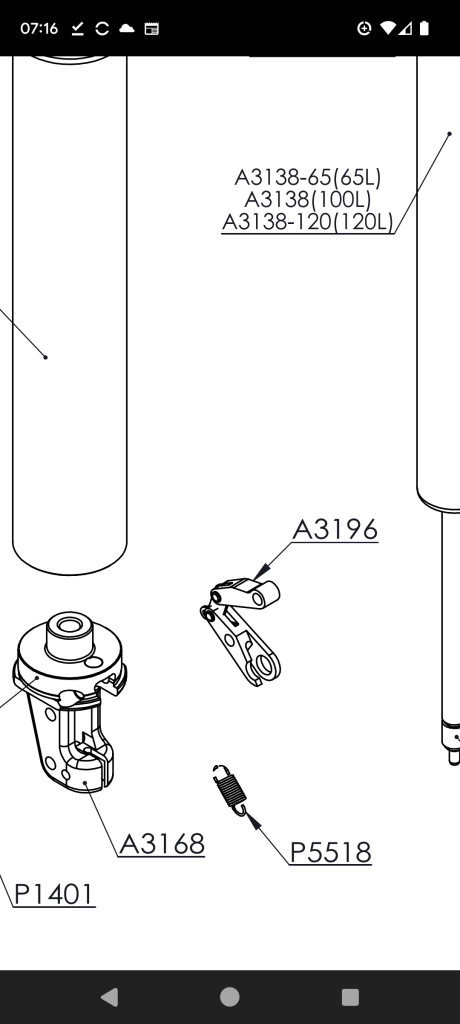

Hmmm, their exploded diagram seems to suggest it might not be broke (though it might be worn...). Anyway, still a pretty shitty design so I'm not sure I'd actually want to replace it with the same

Posts: 205
If anything the diagram confirms that its broken

Posts: 2172
It's 100% broken. The 'hook' part of the retainer is missing. It's fairly common with KS posts, but as mentioned, parts are pretty cheap and easy to replace.
