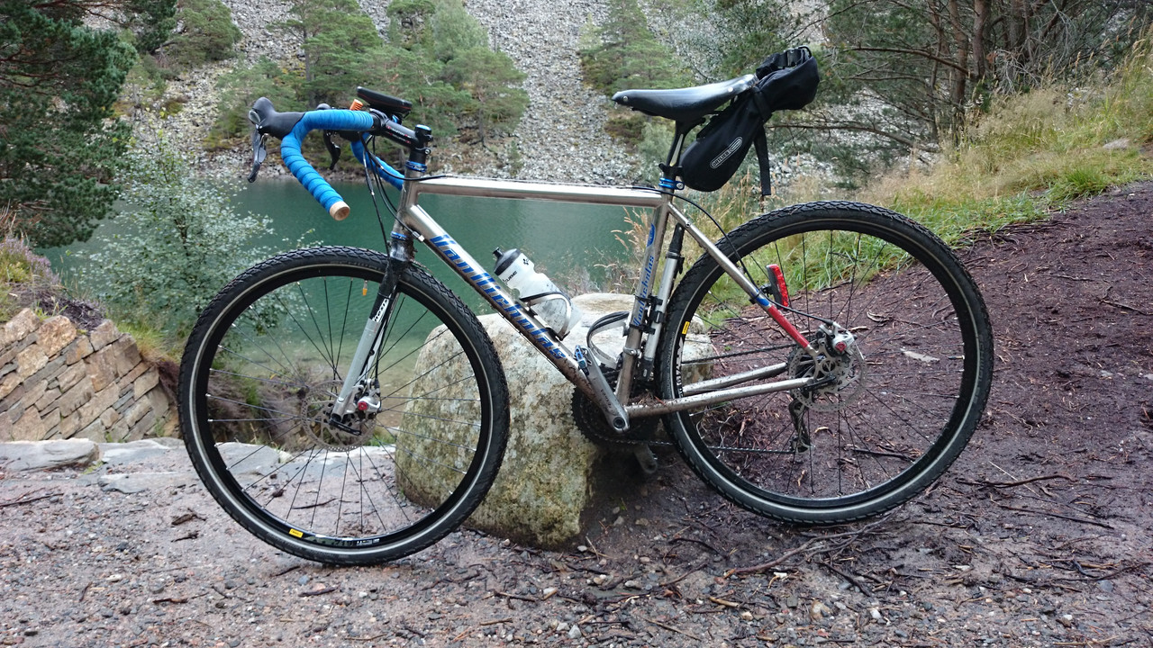

I'm struggling to get happy with the bars on my bike.
When in the drops, the brake levers are a long reach, unless I move my hand up the curve, at which point it's pulling my elbows down and wrists uncomfortable. I end up having to get fingers around the levers and pull just enough that I'm not dragging brakes, just to ensure I can get to them.
When in the hoods it feels ok, perhaps not wide enough, but it tips by wrist upwards compared to my arm. I've angled the brakes a touch inwards at the top, which helps.
Today I rotated the bars downwards more, but it still isn't 'right'.
Could it be the shape of my bar? Perhaps worth trying a different bar?
Also, how do I know what width of bar to go for - I think a touch wider would work better?

Not sure which series of Tiagra you have, but newer ones have proper reach adjusters (no need for rubber blocks)
I would have said also that this levers are fitted too high up on the bars.
Posted : 20/12/2020 12:42 pm

I get this problem. I find anatomic bars work better for me.
like this:
http://www.dedaelementi.com/en/zero-100-anatomic/
I also think your levers are rotated too far round. They need to go a bit more clockwise looking at the picture.

Ooh, I'll check if reach is adjustable.
I did wonder about rotating the levers a touch clockwise.
Then though, being shallow drop, my hand ends in the bottom return curve of the bar - increasing distance to lever tip.
Posted : 20/12/2020 12:47 pm
Posts: 2088
I would say your levers are a little too high. I tend to position mine so the the run from the top of the bar onto the top of the hoods is about horizontal. But personal preference really.
How wide are your bars. I've got On One Midge bars on my gravel bike, think it's 420 at the top, flaring to 560. They're an acquired taste, but I like them. Did take a lot of tweaking to get the shifters at the right height and angle, and also the bars rotated just right. The SSCX bike has a much more modest flare.
Posted : 20/12/2020 12:48 pm

I appreciate that we are all a bit different, but this is how I have the drop bars and levers set up on my two road bikes.
I have small/medium sized hands and can easily brake from the hoods or the drops.
Those bars are Woodchippers, so heavily flared. I don't have a similar photo of my Cube but that uses standard compact drops.
I'd suggest you rotate your bars back to make the top flat/parallel to the ground, then move the levers back down so that they are upright. Try that a few times before finally re-taping.
Posted : 20/12/2020 1:06 pm

I always aim for the tops of the hoods to be horizontal and a nice flat transition from the tops of the bars to the hoods as it gives a big flat area to rest your wrists when holding the hoods. From the photo, I would try moving the levers down. Bar shape does appear to be more round in comparison to the ergo shape of many others

There is no one, universal placement of levers on drop bar. If someone is insisting on that it telling total BS...
What suits you best is the best. Never mind how does it look.
In regards to not reaching to the levers from the drops... Might be that you are just small handed like me and standard drop bars will be too much for you.
Hence I went with Ritchey Beacon. Wide flare and ultra compact drop 80mm and very short of reach 65mm.
Might be that's your golden ticket?
Also sometimes playing with stem that got extreme rise, by extreme I mean like swan neck style stem, or something like Ergotec Charisma High.
That mainly allows rolling handlebars front a lot to shorten reach and drop effectively.

V similar bars to mine but my brake levers are lower and drop section a little flatter.
When in "comfy" position on the drops, my hands are on the flat section and I don't expect to reach the brakes. I move them forward of I need to brake. I'm used to road bikes tho, many years including chain gangs and road races.
I wonder if moving your saddle forward might help the drops position easier? I have also found saddle angle very crucial in terms of whether your hands are pushing/pulling the bars to compensate for it.

Agree with the others that your bars are drooping forwards a bit, and your brakes are mounted too far up the bar to compensate.
I've added mine for comparison...until I just looked at the photo, I would have claimed the flat top of my bars are aligned with the hood of the brake, however it looks like mine actually rise slightly first.
Photo annotations are probably a bit exaggerated but illustrate the difference. Should resolve the wrist angle on the hoods, may help reach the brakes if not, at least make the hand position more comfortable.
Posted : 20/12/2020 1:53 pm
Posts: 13330
I’d be rotating the levers round further round the bars, clockwise on that pic. I’d wind the reach of levers in too.
Id also be looking at the bars themselves, they seem a similar to a pair I had on an old Kona and I didn’t like them at all. RHM Zero bars are a good, compact shape and worth looking at.
Posted : 20/12/2020 1:57 pm

Yeah those levers are pretty high up. I've often had that issue but for me it was really caused by the bars being too low.

Another for bars too far up, your saddle looks quite far back as well.

Looks like they are angled upwards?
And mounted too high, as others have said.
Posted : 20/12/2020 10:12 pm
Posts: 5042
I, like several other posters, also think your levers are a little high in the original pic.
If you’re going to move them, mark the bars with a sharpie pen, so you can move them both by the same amount.
There is no ‘right’ or ‘wrong’ way really, what matters is whether they are comfy or not.
But, having said that, spooky’s picture is very close to what i do.
Also, as others have said, some people just never get on with drops at all.

Roll the bars forward a bit more. The extension on the drop is designed to be level a la:
Reach to the levers will probably be reduced by 20mm+!
EDIT: Bar width usually dictated by distance between Acromiom which puts the majority of men on 40cm (c-c) although sizing up will help with stability riding off-road. Most off the shelf bikes come with 42cm as stock.

Everyone’s different, but for me before I put the brakes on I like to set the bars level as they sweep forwards so the lead in to the hoods is level. Then the brakes go on with a really small up lift on the hoods, erring on the side of flat.
For me the OP’s photo has the bars rotated too far forward (clockwise in the photo) and the brakes are too high on the bars.
Rotating the bars back and pushing the levers forward on the bars would both give me a more natural position and bring the lever tips closer when in the drops.

I’m aware that the reach of the levers is very tight. It was the only way I could reach them with the old bars. I’ll loosen them off a bit when I’m sure I have a good position.
PS comments about state of garden, dirtiness of chain, etc all considered.

Finally some bar tape arrived to enable me to have a play.
You can see old lever position (background) after I've rolled the bars flatter. The new rolled up bars with moved down lever position does indeed increase reach, a lot. I've moved saddle forward.
Posted : 10/01/2021 2:59 pm
 isoo
To me it looks like your bars have a classic bend, where you're not supposed to get a flat ramp leading into the hoods. Like on Scotroutes' first photo above. That way you just hook your thumbs on the lever, which really isn't the way modern brake levers are meant to be used. It will also lower your hood position significantly.
So new bars might be in order...
Posted : 11/01/2021 12:25 pm

I'd roll the bar forward and move the lever up the bar a bit (quite a lot, actually).
Posted : 11/01/2021 12:49 pm
I’d roll the bar forward and move the lever up the bar a bit (quite a lot, actually).
Which would take me back to my starting position, that doesn't work for me...
I do think new bars may be needed...
Posted : 12/01/2021 4:55 pm
Posts: 13330
I don't think you're far off. I'd move the hoods up a touch, not much, and you're about there.
Posted : 12/01/2021 5:02 pm
That's what I've settled on @lunge - bars as is, shifter nudged up a touch.
Posted : 12/01/2021 5:24 pm
Give it a go, but you may prefer a bar that has the same shape at the top but curves round closer to flat (or even slightly upward) at the end.
I certainly like that kind of shape, so I've got something to push against when honking out of the saddle.

An update.
The bars are better rolled up more and levers further around. I prefer them.
I am still not convinced that I have the 'right' shape of bar for me / my wrists. It is princess and pea stuff still - it feels that when I ride on the hoods it is a good pull forward. it feels a touch 'odd' to be in the drops, it pulls my arms in (too narrow? no flare?) and means the reach to the brake constantly feels a stretch in my hand.
Please recommend some other bars to try - I ride 80% road, less reach would still be good. Cheap too as I cannot spend dafty money trying out ideas.
