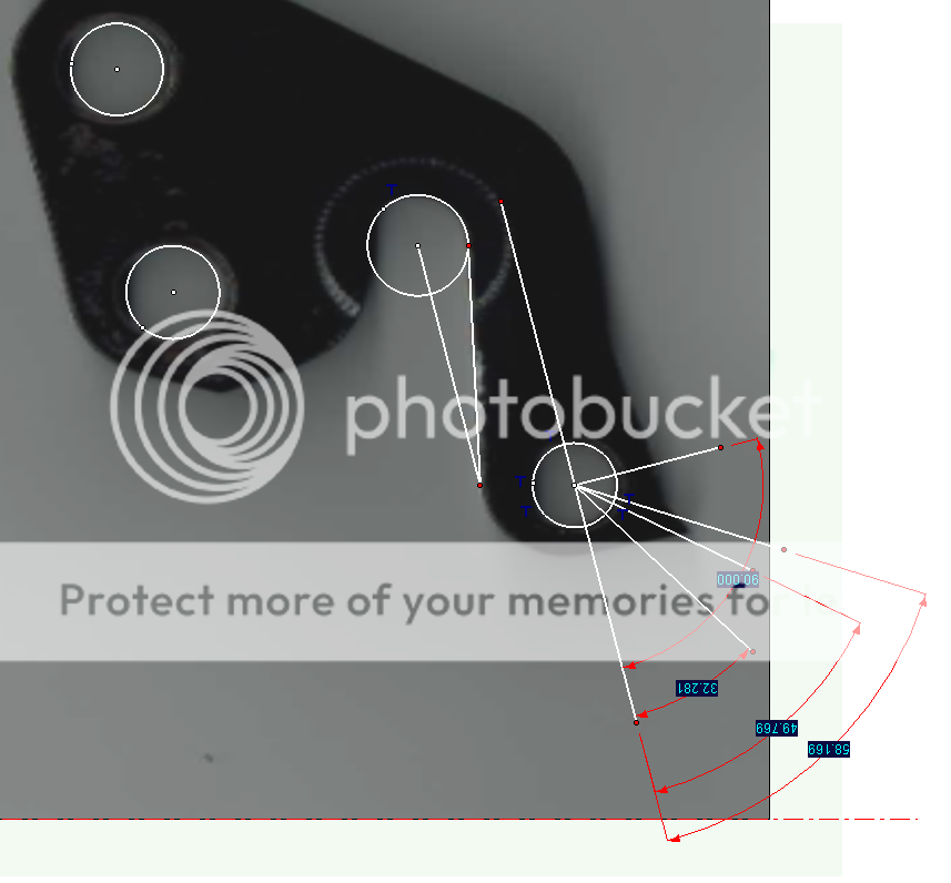

As someone who's spent a bunch of time with stock and tweaked derailleurs (and the guy who designed the GoatLink), I'm going to say that (as others have suggested) the hanger looks way off. Here's Shimano's specification:
[URL= http://i33.photobucket.com/albums/d87/Aydynj/2885252658_b55650152d_o.jp g" target="_blank">http://i33.photobucket.com/albums/d87/Aydynj/2885252658_b55650152d_o.jp g"/> [/IMG][/URL]
The b-tab looks to be quite a good 10-15 degrees further clockwise from where it should be, which will muck with the derailleur position, reducing chain wrap and impacting shifting. Shimano DM rear derailleurs (with a DM link) aren't really adjustable there, so any weirdness is amplified. Have Production Privee been responsive to any messages?
Very useful to have your input Mr Goatlink, thanks.
So do you think the Goatlink will improve matters or not make much difference?
Ultimately I may have to see if I can get different dropouts machined maybe.
I think this is clearly the root cause of the issue. Funny though how with the bigger wheels (and appropriate dropouts) that the cable tension arm is so much closer. Perhaps the dropout is laterally different too? 😐

This is my 2nd hand frame but with brand new xt771 cassette, and brand new RD786 rear mech, one up 42t and radr cage. (pic taken whilst frame upside down). The mech is hard up against the B stop.
As you can see the angle is very much wrong compared to any other shimano equipped bike. eg here is my mega TR and the wifes trigger.The shan is about 20-30degrees off the horizontal
So I did a rudimentary 5 minute measure by scanning the hanger (luckily its flat), scaling the image in cad to make sure the hole sizes were correct and then measuring a few angles.
If you add the shimano recommended 30degree (well I did it rough its 32) line you can see the hanger is miles off, its somewhere between 45 and 59degrees where it contacts the mech. According to the shimano drawings above (reprinted below for ref) the angle of the b-tab contact face on the tang should be radial to the centre of the mech bolt hole, of which it is a looong way off. This need proper measuring to be sure but I recon I am accurate to at least 5 degrees, which even so puts us somewhere around 20-30 degrees off..
(Note that the "vertical" I have taken the angle off is parallel to the line from the centre of the axle to the tangent of the OD of the hanger -these dims are prescribed in the shimano doc)
So I tried it with the expander ring removed, the normal cassette (11-36) and it still has only about 110 degrees of engagement as per kayak and does not shift well. I do know how to set up a mech..
So far, I emailed PP yesterday but have not had a response, yet. I called and apparently the technical guys are away until tonight.
TBh I am double peeved as I bought his for my fast growing daughter, and then got a bit excited and got the 27.5 Shan 917, the last one in small, for myself, but I have had a look at the hanger and a brief inspection reveals that 2 years later, the 2016 model still has the same issue. as per Kayak, doom as I was about to order the 26 drop outs too..

Posted : 08/11/2016 5:55 pm

And here is an overlay image of the two. The reddened one above is the original one with the newer one at the back.
They may not be lined up perfectly (I was balancing on a stool trying to be directly above) but you get the idea.
Quite a difference in the tab position.
Posted : 11/11/2016 8:38 am
Bang on shimano standard. Good stuff.
