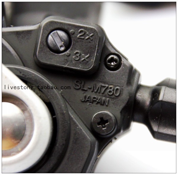

If you are lucky, your shifter may be switchable from 2X to 3X. If Shimano, look for a little switch or screw underneath (RTFM before fiddling with it, though, as things can break if you try and change it with the shifter in the wrong place)
E.g.
Or
