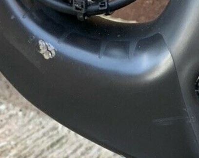

Eyeing up a used bike and I see it has this chip. Does it matter? Never had a carbon frame before so know nothing about them.

It's under invisiwrap so might not be as bad as it initially looks. Might, being the operative word as the wrap is also obscuring the damage to a degree. To help the guys on here give you a better idea, any chance you have closer/better pics of the damage?
Opinions will also, to a degree, depend upon the price of the bike mate. To what extent the the potential "risk" is factored into the selling price.

Looking at that crank arm I’d want to see the underside of the bb,
I’ve always had a rockguardz on my 5010 first one shattered with a right bang..

Looks OK to me that.
Open the pic in a new window and you can zoom in - it's quite hi-res. I still couldn't say for sure though. Nothing that bad on my rather battered Rocky Mountain.

The thick black line looks a bit suspect to me.

If you can squeeze it and feel the fibre giving under the pressure, it's not great. I would almost be inclined to use a holesaw to remove the damaged area leaving a nice clean round hole, which I would either fill with resin or plug with a blanking grommet. At least it's in an area where you will see if a crack starts.

Thanks guys, it's a Bronson and the seller is asking £1700, good price I thought. Unfortunately I only have this pic to go on. Might get in touch and see if they can send me a closeup. It's quite far away from me so bit of a commitment to go see in person.
From the sounds of it I might be better off leaving it be.

I think I'd pass on the bike tbh, there'll be other Bronsons for sale

Looks like it's just the invisframe, I'd not worry about it.

That section of Invisframe needs to come off. I believe they sell individual pieces.

Looks like how my invisiframe gets ‘scrunched’ in a Thule roof rack clamp.

Have they described it as a chip in the description?
It could just be a tear in the invisiframe and that's dirt underneath

Yeah, that's just damage to the invisiframe tape from a thule roof rack.
I'd be 99%certain that the frame is undamaged under that.

It could just be a tear in the invisiframe and that’s dirt underneath
Exactly what it looks like to me.

I've got a spot like that where an invisi frame section is.. on my top tube (alloy frame) where careless positioning of d-lock (or someone's yanked the bike when it's been locked).
Invisi frame tends to do that when it's clamped or banged a certain way, it kinda bunches up, then you get a bit of air and dirt under it.
As said above that section of protective tape needs to be pulled off really, the damaged tape is likely making it look worse than it is. It might just be a paint chip underneath.

My Nomad is covered in similar looking Invisiframe marks from crashes, rock strikes etc. Mind you I can see and feel my frame, I’d be wary of parting with hard-earned without seeing it.
