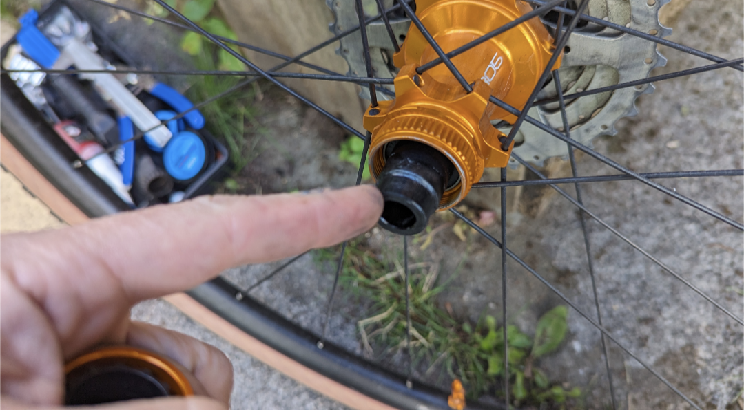

Does anyone know how to remove the spacer from a hope Pro 5
I need to remove it so that I can screw in the retaining ring for the disc brake. On the front I could just pull it out, screw in the ring and then push it's back in after.
Does the rear pull out the same? It seemed very stiff but do I just need to give it a bit more ooph?

Just pull the end cap, bit of a wiggle perhaps, maybe if you're feeling brave a set of mole grips or a vice.

Yeah they just pull out, friend says you can walk the endcap out using the axle slightly inserted into it, though I've yet to try this method, & have just ended up using mole grips previously in frustration.. or if you have slide hammer the small bit might fit it? (basically a Unior Hub Genie )

Bought one and while ago and the shop ordered the version with the wrong freehub, when I pointed this out the lad in the workshop pulled the endcap off by hand and swapped them in about 30 seconds

grab and pull. Agree that pliers may make a mark, but in reality you won't see them that often (so pliers if really stuck!)

pliers with a thin bit of rubber/latex over

Or get a bench vice with soft jaws, gently grip the end cap in them with the hub facing up and then hold the rim pull directly up.
If it's being stubborn try a 'rolling' motion to work the cap loose then pull directly up again.
The extra leverage of holding the rim or tyre tends to make cracking them loose a bit easier.
It's how we deal with stubborn ones in the workshop.

I don't have a hope pro 5 but I've found wrapping a bit of innertube around end caps can give the grip required to pull it off, normally with some wiggling.

Bitter experience of these. They are stiff to pull out, but they do. I actually brought a tool to do it in the end.
https://www.certini.co.uk/bike-maintenance/tools/unior-hub-genie-12-and-15mm--black__84750?currency=GBP&chosenAttribute=UN627272&srsltid=AfmBOoptCkt8Q9kcta9GnAD28YuEWgTM03H0aufGmwSLgtQoyE_hhBCbgXQ
They re expensive but work. Once out and you discover Hope assemble stuff with no grease, then they pull out easier. On that note, check you free wheel on these hubs, mine had no oil or grease inside and got gummed up very quickly with corrosion. I also put a space in whilst I was at it because I found my cassette wasn't tightening, even though the online guides said you didn't need one, this is probably why my hub was pretty knackered inside, after only 8 months. Now mine is service how I want it, it runs lovely.

Do you need to take it off because the disc lockring physically won’t fit over it, or because you can’t get the tool in to fit the lock ring?
If it’s the latter, you know you can get Centerlock lock rings designed for thicker axles that use a bottom bracket spanner? Shimano SM-HB20.

Regarding the reason why I want to remove this, I have the external Shimano rings at the moment and the gap especially at the front is absolutely massive meaning it. On the left hand side you can see the seal of bearing. Now I've used the rings that use the cassette tool - The gap between the axle and the hub is now a lot smaller and I'm hoping a lot less gunk will get in there.
I'll put leather around some mole grips and work it out 🙂 The front ones come out by hand only

put it in the vice with some leather pads on the jaws and it popped off, all now done and i have matching orange hubs and lockrings 🙂
